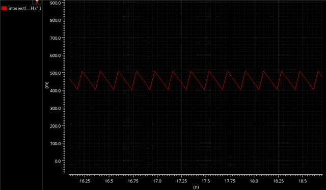

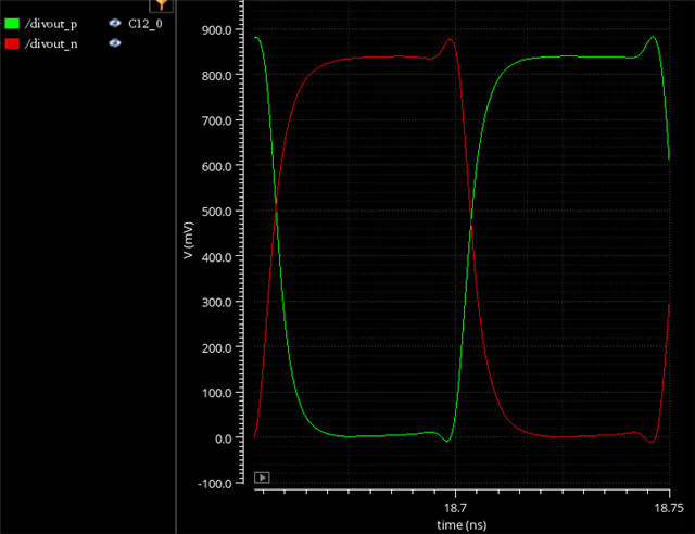

    Did you happen to try the xval() function on the resulting intersect operation? For example, in Figure 1, I show two waveforms (divout_p and divout_n) that intercept twice every waveform period.  I use the following Calculator intersect expression and plot the result in Figure 2:
    intersect(leafValue( VT("/divout_p") "freq_GHz" 16 ) leafValue( VT("/divout_n") "freq_GHz" 16 ) )

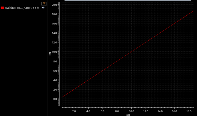

    In Figure 3, I then apply the xval function to the result with the Calculator expression and plot the result in Figure 3. There are many waveform intersections and hence the result appears as a waveform. Alternately, you could append the result to a table or select the waveform in Figure 3 and export it. Since the waveforms intersect at the same timepoints the x and y coordinates of the waveform are identical.
    xval(intersect(leafValue( VT("/divout_p") "freq_GHz" 16 ) leafValue( VT("/divout_n") "freq_GHz" 16 ) ))
