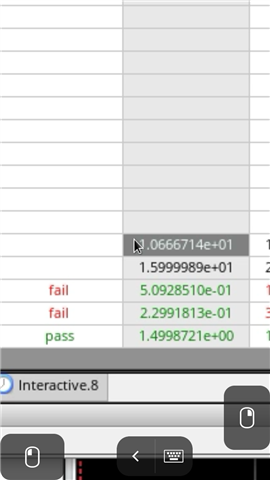

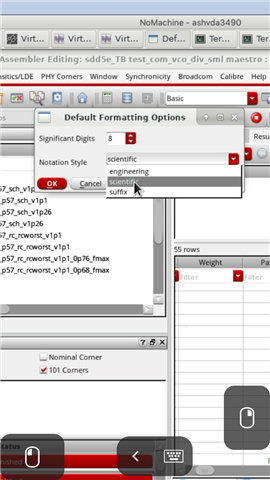

    Secondly, with respect to your question concerning fixing the number of decimal characters in the Output tab, have you considered changing the format of the output setting? As shown in Figure 1, if I change the format to "scientific" and select 8 digits, the format of the output values shows
    Does this address your question or did I not understand correctly?

    In any case, the output format with scientific selected as the format will provide N-1 fractional digits if you specify N as the number of significant digits. With N = 8 selected in Figure 1, there are 7 digits representing the fractional part in Figure 2.
    Shawn

    Your solution works, however in scientific format it is very difficult to read the data. for e.g 14.3 becomes 1.43e+02
    An engineering format works best, but in that mode it seems no other option to control the display of digits in fraction.
