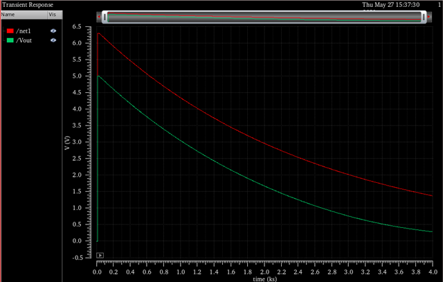

How can I reverse the color of the black background and the white axis value?
yysunj
yysunj over 5 years ago
This is my simulation result.
How can I reverse the color of the black background and the white axis value and axis?
I want to reverse the color of the black background and the white axis value and axis, but I do not know how can I do this.
Please tell me.
Thank you
yysunj
    You can change it on Edit->Multi Graph Properties - change the window background color. In IC6.1.7 you could change it per-subwindow via Graph->Properties (although I'd say that was rarely useful)
    If you want to change it by default, add this in your .cdsinit file:
    ; in IC6.1.7 and earlier
    envSetVal("viva.rectGraph" "background" 'string "white")
    ; in IC6.1.8/ICADVM18.1 and later
    envSetVal("viva.graphFrame" "background" 'string "white")
