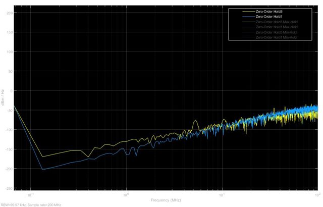

abdurrahman0234
abdurrahman0234 over 5 years ago
for the 10n clk and 36 bit input, What number of sample count should be  in the  0-100Mhz for power spectral analysis? I know that sample frequency 200e6 in this range. According to this, I run the simulation to look pwer spectral density.
Can u help me, please?I think that minumum 1024 sample count is enough to look in the psd

    İnput 36 bit digital bus at the 100mhz clkk frequency. İ want to look psd in the range of 0-100M interval. But plot has full of noise in result of Delta sigma modulator while getting output, i think correct circuit

    all  of signals are digital, it is digital circuit. Intended frequency range 100 mhz to look psd. clk is 10ns.Output is as below. I dont understand, why noise is high?

    I referred digital bit signal output. Ut should be 150 mhz interval. İt doesnt matter interval. but psd look noisy. sample frequency 200e6 sample count 8192 transient time 40u

  • ShawnLogan
    ShawnLogan over 5 years ago in reply to abdurrahman0234
    Dear abdurrahman0234.
    From the small sample of the time domain response you provided, the frequency content of your signal far exceeds 100 MHz as the transition times have components of frequency much much greater than 100 MHz. Hence, sampling at 200 MHz will not accurately show the signal spectrum as high frequency components will be aliased down to low freqencies. Hence, the Fourier analysis you performed will not accurately represent the Fourier components of the signal.
    Shawn
  • abdurrahman0234
    abdurrahman0234 over 5 years ago in reply to ShawnLogan
    what ı can do?I noticed that it shoıws dB. I think that it should be dBm

    abdurrahman0234 over 5 years ago in reply to abdurrahman0234
    it should be like matlab simulation as shown below figure

  • ShawnLogan
    Dear abdurrahman0234,
    abdurrahman0234 said:
    what ı can do?
    I've given you a number of suggestions, and in addition,  you have not provided the information I requested nor attempted to try any of my suggestions. As mentioned in my prior post, your sampling frequency for your Fourier analysis much be much greater than 200 MHz to accurately estimate its Fourier components.
    Without more help from you, I cannot provide any helpful suggestions. Sorry.
    Shawn
  • abdurrahman0234
    When I take greater sample frquency, it doesn noıt change, I still take  same noise
