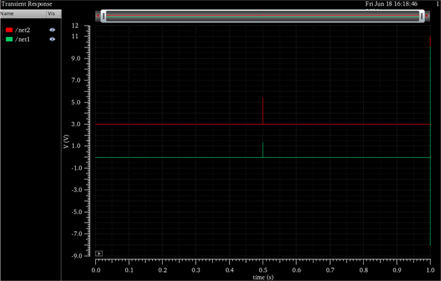

This is my simulation result.
By the way, I want to adjust time range from 0~1.000055s to 1~1.000055s.
How can I do this?
Please tell me
Thank you
yysunj
    If you go over the zoom bar at the top (the horizontal bar below the date on your graph above) and do Right Mouse->Zoom to you can enter the start and stop values for a horizontal zoom.
    You can also interactively drag over the area by holding the shift key down whilst you drag the right mouse button, which will do an x-only zoom.
    Or you can constrain the x-axis by going over the axis itself, and doing right mouse->Axis Properties, and then on the Scale tab pick "manual" and enter the axis range (if you do that though, you can't zoom back out again without changing the axis back to automatic or to a wider range).
