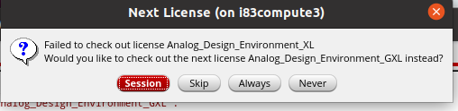

Hello everyone,
I can't start adexl because in license-check step(following figure) I selected "never"
And now I get error when I start adexl.
Is there a config file that I can correct the license-check operation?

    Holz, You can correct this using the Options->License UI in the CIW, and then go to the "Ordering" tab. You can also check to see if any entries have been saved into your ~/.cdsenv file related to…
    Holz,
    You can also check to see if any entries have been saved into your ~/.cdsenv file related to licensing (if you remove those, and then restart Virtuoso).
