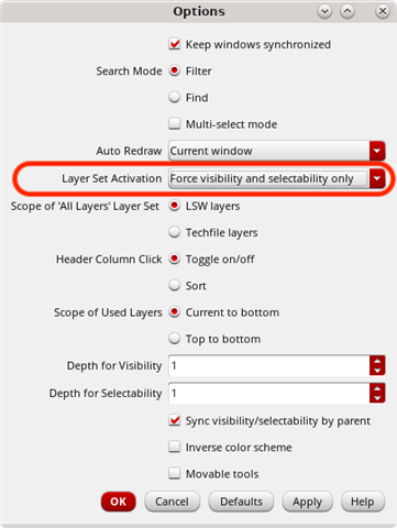

Is there an easy way to configure viewable/selectable sets of layers in virtuoso that I can store and recall as needed? I'm constantly viewing a given subset of all available layers and finding myself needing to view just one or two layers to e.g. fix a DRC error, but afterwards it's a pain setting up all the layers again so I can continue browsing the layout. I do this very many times a day, so I'm kind of hopeful this functionality likely already exists.

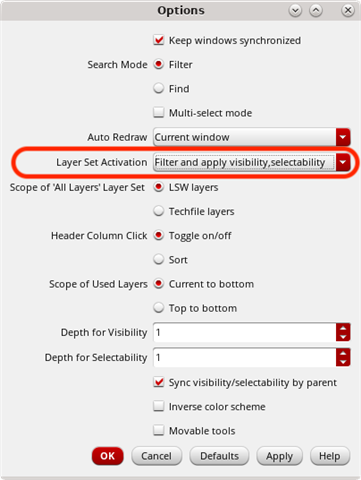

    By default, the layer sets (which are saved under the .cadence dir when you do Right Mouse->Layer Set->Save over the palette and so can be reused in subsequent sessions) but do not honour the visibility/selectability.
    That can be controlled via the Right Mouse->Options form:
    This can be set with:
    envSetVal("layout" "pteLayerSetActivationMode" 'cyclic "filterAndApply")
    The other choice is to pick:
    with the corresponding cdsenv setting:
    envSetVal("layout" "pteLayerSetActivationMode" 'cyclic "filterVisSelectability")
    The first just alters the filtering and applies the selectability/visibility within the layer set (leaving everything else as-is). The second will make everything else invisible and then apply the selectability/visibility from the layer set.
    I'm not entirely sure I have understood precisely what you want, but it may be the second of these two choices?

    Thanks Andrew - this is (kind of) what I was after, although (based on what I saw) your sentence "The first just alters the filtering and applies the selectability/visibility within the layer set (leaving everything else as-is). The second will make everything else invisible and then apply the selectability/visibility from the layer set." is backwards i.e. I noticed that the FIRST will make everything else invisible and then apply the selectability/visibility from the layer set.
    That being said, I now realize my original question was vaguely worded. What I was really after was looking for a simple way to "push" the current layer visibility/selectability set, then refine the visibility to some random subset while I focus on e.g. a specific set of DRC errors, and then later "pop" the original layer visibility/selectability set (ideally something I could do with bindkeys). Is that possible?
