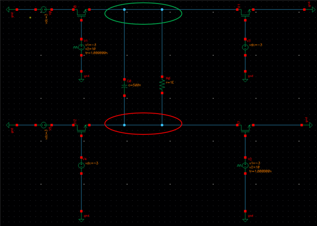

Below Figure is my circuit.
I want to find the voltage difference between green node and red node.
But, I do not know how can I get this.
How can I find the voltage difference between two nodes?
Please tell me
Thank you

    If this was a transient simulation (you didn't say), you could use Results->Direct Plot->Transient Difference. Or you could (for many analyses) use Results->Direct Plot->Main Form and then pick the analysis, Voltage, and for Select choose "Differential Nets" and then you'll be prompted to click on the two nets.
    Or you could use the calculator and use (say) the VT function or VDC function for each of the two nets and substract the results.
    This seems staggeringly basic, so I can only assume there must be some complexity in what you're attempting to ask that you've omitted?
