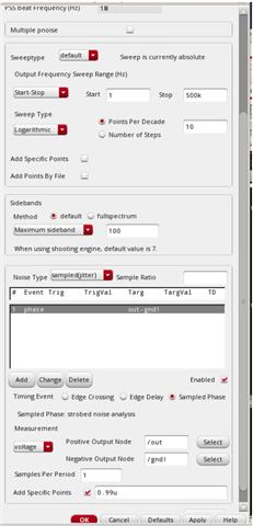

It's been a while since I ran pnoise and for that time I see the gui has changed. Before when I was simulating sampled circuits I could choose Noise type: timedomain and then Add Specific Point of time at which I wanted to get the noise - usually at the end of the tracking phase. Could you please help me find these things now with the all new GUI? Thanks
Svilen
    Hi Svilen,
    Pick "Sampled Phase" as follows:
    Having set it up with the output node and the points to add etc, hit the Add button. You can add more than one sampled noise analysis this way.
  • Svilen64
    Svilen64 over 5 years ago in reply to Andrew Beckett
    Thanks, Andrew, for the prompt reply. Here is an attachment of my setup - hopefully it is correct. One additional question. There used to be an option of also specifying the input voltage source or port to which I could refer the noise. Now I see only an output node. Can I still refer the noise to the input?

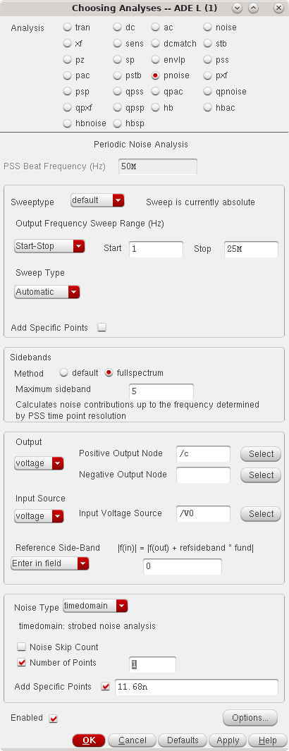

    Andrew Beckett over 5 years ago in reply to Svilen64
    Whilst the old form did allow you to specify an input source (this is from an IC616 ISR dated from about 6 years ago):
    The pnoise analysis (when in time domain mode) ignored it - there was nothing on the "tdnoise" Direct Plot form, nor is there any input-referred noise in the results browser.
    I did some searching and as far as I know, this has never been possible. It's questionable whether it is going to be useful either - the noise you are seeing at the sample point may originate from earlier times in the PSS period (it may have been sampled and held for example, or as a result of some delay in the circuit propagated to the output); input referred noise is normally computed by dividing the output noise by the gain - and if we computed the input referred sampled noise it would be the gain at that instant which may be completely irrelevant (there may be no gain at that instant in time). So which gain would it be expected to use?
    Of course, if you know the gain you want, you can simply divide the sampled output noise by that gain (if there is some specific meaning in your case).
    If you are computing the normal time-averaged noise (a.k.a "sources" in the past) then you can of course specify an input source. Rather unhelpfully in current versions you have to enable the "Noise Figure" checkbox to enable the specification of the input field (even though you're probably not measuring noise figure in a switch cap circuit, probably).
    Overall I don't understand how you managed to do this in the past - are you sure you really did? As I said, as far as I can see from my checks this wasn't possible (I even found a request for it and a discussion similar to the above from R&D when I just looked).
