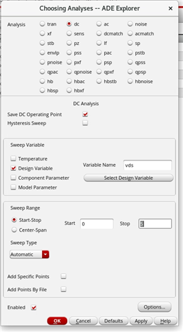

Greetings everyone,
I would like to ask for some help with an issue that I have been facing while running simulations on a single transistor circuit.
The process of creating the circuit and setting up the simulation follows below:
  1. Launch Virtuoso - command: virtuoso&
  2. Virtuoso loads the 45nm PDK library without any errors
  3. Using the Library Manager - Created a new library and two cell views (one schematic and one maestro view)
  4. Created the circuit shown in Picture 1 - The transistor used the default library values for the nmos1v model.
  5. Setup the simulation
    1. Simulator: Spectre
    2. Variables: vgs= 1V, vds= 0V
    3. Chosen Analysis: dc, Save DC Operating Point: Enabled, Sweep Variable: Design Variable: vds, Sweep Range: Start 0, Stop 5, Sweep Type: Automatic. (Picture 2)
  6. Run: The simulation was completed successfully with no errors.
  7. Setup the simulation
    1. Using the calculator: operating point sweep (os)
    2. Selected the transistor model
    3. Selected the following parameters: drain current (id), rout, vearly, lambda (1/vearly) (Picture 3)
  8. Run: The simulation was completed without errors, the graphs looked normal but the value fields were showing "eval err" (Pictures 4 and 5)
  9. By adjusting the variable: vgs= 1 2 3 4 5, and trying to run the simulation as before (dc sweep of vds from 0 - 5 with the additional 5 sweeps of vgs) the simulations get stuck on "pending" until the message in Picture 6 pops up.
Below you will find the pictures I have mentioned in my post to help with recreating the process I followed by the netlist of the circuit.
Additionally, I have run the checkSysConf command and attached the output files from that bellow too.
Thank you in advance for any help on the matter.
Picture 1 - Single transistor circuit - schematic view.
Picture 2 - DC analysis setup window
Picture 3 - Simulation Expressions
Picture 4 - Expression Outputs
Picture 5 - Output graphs
Picture 6 - ADE Assembler Message 1921

->  'Xvfb'
Configuration checks failed on this workstation (cad), status is: FAIL
This system does not have the correct packages to run ICADVM20.1
Run checkSysConf ICADVM20.1 -P <PACKAGE>
to find out which products require this package.
Exiting checkSysConf ... Good-bye
Output is saved as /tmp/checkSysConf.cad-2021.07.10.14:51.18486.log
Fullscreen netlist.txt Download
// Point Netlist Generated on: Jul 13 18:51:31 2021
// Generated for: spectre
// Design Netlist Generated on: Jul 13 17:59:34 2021
// Design library name: test01_08_07
// Design cell name: stc
simulator lang=spectre
global 0
parameters vds=0 vgs=1
include "/home/cs2039460/45nm_library/gpdk045_v_6_0/models/spectre/gpdk045.scs" section=tt
// Library name: test01_08_07
// Cell name: stc
// View name: schematic
V1 (net2 0) vsource dc=vds type=dc
V0 (net1 0) vsource dc=vgs type=dc
NM0 (net2 net1 0 0) g45n1svt w=(120n) l=45n nf=1 as=16.8f ad=16.8f ps=520n \
        pd=520n nrd=1.16667 nrs=1.16667 sa=140n sb=140n sd=160n \
        sca=226.00151 scb=0.11734 scc=0.02767 m=(1)
simulatorOptions options psfversion="1.4.0" reltol=1e-3 vabstol=1e-6 \
    iabstol=1e-12 temp=27 tnom=27 scalem=1.0 scale=1.0 gmin=1e-12 rforce=1 \
    maxnotes=5 maxwarns=5 digits=5 cols=80 pivrel=1e-3 \
    sensfile="../psf/sens.output" checklimitdest=psf
dcOp dc write="spectre.dc" maxiters=150 maxsteps=10000 annotate=status
dcOpInfo info what=oppoint where=rawfile
dc dc param=vds start=0 stop=5 oppoint=rawfile maxiters=150 maxsteps=10000 \
    annotate=status
save NM0:vearly NM0:id NM0:rout
