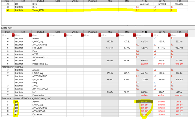

    after using cross() properly over the "sweeps" (not "points") I got my "Vtune_480M" values.
    Now:

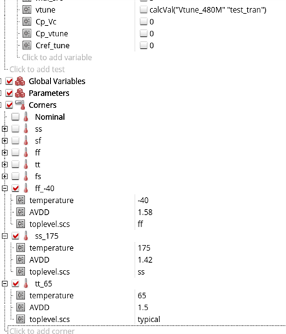

    1. It is displayed as a curve (not a constant) - maybe because I do a corner sweep and have different VDD values per corner

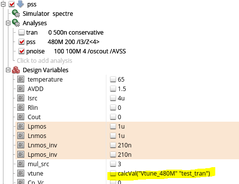

    2. I want to use this Vtune_480MHz value as the Vtune for my PSS+Pnoise simulations, but currently this does not work. The PSS says the value is NIL
    Any idea ?

    This would be the corner setup - AVDD, temperature and the process-corners are changing

    I'm a little busy today, so can't delve into this too much, so a quick suggestion to see if you can move forward. Perhaps just try adding ymax(expression ?overall t) around your expression - so ymax(cross(...) ?overall t) - I'm assuming that the graphs are single-point graphs but with the other corner variables showing up? This should then scalarize (if that's a word) the result...
  • HoWei
    HoWei over 5 years ago in reply to Andrew Beckett
    Your proposal ymax( ... ?overall t)  "scalerized" the value and a number was given.
    And also the PSS+PNOISE simulations are running succesfully!
    Perfect ! Problem solved !
