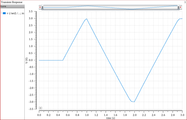

I got my simulation result at cadence virtuoso.
Fig.1 is my result.
Fig.1

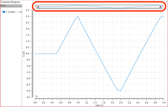

And, I know how can I enlarge the result window in the vertical direction.
Fig.2 is the result obtained by magnifying it in the vertical axis direction.
Fig.2
And, I want to enlarge the result window in the horizontal axis direction, but I do not know how can I do this.
How can I enlarge the result window in the horizontal axis direction?
Please tell me

    Go over the zoom bar at the top:
    and do right mouse->Zoom out x2. You can also drag the ends of the zoom bar to expand in the x-direction - or use the right mouse button menu to  fit in the x-direction only.
