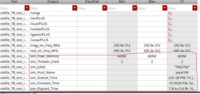

    2. Are you sure you have allocated sufficient memory to your jobs? If not, perhaps this is why some of your initial simulations are failing. Add the following to you .cdsinit file and restart Virtuoso. This will add some data on memory usage for each job:
    envSetVal("maestro.results" "defaultRunStatisticItems" 'string "memory,threads,jobId,host,startTime,endTime,elapsedTime")
    as shown in Figure 1.

    I added envSetVal("maestro.results" "defaultRunStatisticItems" 'string "memory,threads,jobId,host,startTime,endTime,elapsedTime"), I have re-run the simulation, some points still crashed.

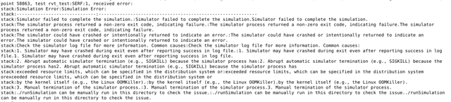

    When I ran the simulation, I got around 3000 pints which failed, here is the info I got:

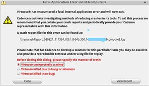

    And before the simulation finished, virtuoso crashed:

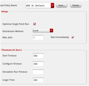

    4. The crash log itself that was mentioned in the popup you got when Virtuoso crashed would have helped diagnose this - otherwise it could be many things. If you're really running 3000 simulations but only one in parallel, it seems unlikely that memory is being exhausted, but who knows as there's very little data here?
    5. Yes, you should contact customer support - especially if you can't provide information here about the crash. Diagnosing crashes is generally going to be quite difficult for somebody who doesn't work for Cadence (such as Shawn, who is very helpful on these forums but doesn't have access to some of the internal Cadence tools that those of us that do work for Cadence have access to). Of course, it might be something obvious, but without more information it's going to be very hard.
