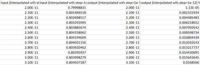

I'm running a simulation with 50000 sweep points and I want to export result of each simulation into a csv file, so I want to have 50000 csv files.
As already mentioned in https://community.cadence.com/cadence_technology_forums/f/custom-ic-design/48506/how-to-get-values-of-sampling-points, it's possible to use the "sweep variable" as "VAR()" in Ocean script, but in my case, I have many sweep parameters and I don't care about which result is related to which parameter, what I want to realize is like a for loop:
                                              for (N=1,N<=50000,N++)
                                                    generate ("result_N.csv")
How can I realize it? Another question is, when I use "awySaveToCSV" to save the sampled input and output waves, I also have two time step columns, can I delete one in ocean script?
Thanks for help!

    This can be readily accomplished using an ocean script, Holz.
    An ocean script can call a UNIX command using its system() function and hence one can use the UNIX cut and paste commands or issue an awk command. As an example, I created a test_in.csv file and illustrate the use of the UNIX cut command to remove the time columns with the exception of the first time column:$ cat test_in.csv
    $cat test_in.csv
    Time1,wave1,Time2,wave2
    0,0.25,0,0.125
    1,0.5,1,0.25
    2,0.75,2,0.375
    3,1.0,3,0.50
    $ cut -d"," -f1,2,4 test_in.csv
    Time1,wave1,wave2
    0,0.25,0.125
    1,0.5,0.25
    2,0.75,0.375
    3,1.0,0.50
    $ cut --complement -d"," -f3 test_in.csv
    Time1,wave1,wave2
    0,0.25,0.125
    1,0.5,0.25
    2,0.75,0.375
    3,1.0,0.50
    I can create an ocean script to invoke the command "cut --complement -d"," -f3 test_in.csv" on the sample input file and store it in the new output file test_out.csv as follows:
    $cat cut_function.ocn
    simulator 'spectre
    sprintf(filename_in "test_in.csv")
    sprintf(filename_out "test_out.csv")
    ; or alternately
    ; filename = strcat("test_in.csv")
    sprintf(cut_field_3_command "cut --complement -d\",\" -f3")
    sprintf(apply_cut_command "%s %s > %s" cut_field_3_command filename_in filename_out)
    system(apply_cut_command)
    exit()
    Running the ocean command using:
    $ocean < cut_function.ocn
    The ocean script, output log, test_in.csv, and test_out.csv file are attached as a compressed archive.
    At this point, I am thinking you might consider learning to write an ocean script as this will easily allow you to create and customize the output formatting and create your 50,000 files with their simulation number in the filename.
