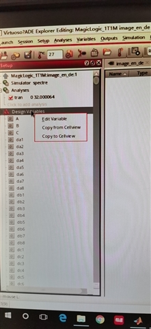

    Hello, Andrew.  I am simulating a large circuit which has hundreds of parameter variables using ADE Explorer or ADE L.  I manually assign valus to variables one by one, which is a huge project. To make it easier to assign values to variables, I found a method on the Internet, that is, "I right click on the top of Design Variable, I can export them to CSV. Then I can modify form there. Once done, I can select import from csv". When I follow this method and right click "Design Variables" in the ADE Explorer, there are no export to csv and import from csv in the menu, as shown in below picture. I am confused. My cadence version is cadence IC617.
    Andrew Beckett over 4 years ago in reply to Roly
    You must be using a pretty old version - this was introduced in IC6.1.7 ISR6 5 years ago - your image shows Explorer, so you must be using something between the base release and the first five hotfix versions.

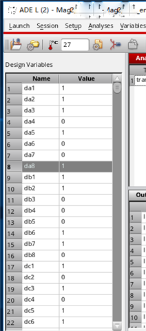

    Hi, Andrew. I applied to the school for an account using Cadence. I don't have permission to modify the software. The specific version is IC6.1.7-64b.500.1. In my circuit, there are hundreds of parameter variables. I need to simulate my circuit hundreds of times, and each time I had to modify design variables. Now, I manually assign valus to variables one by one in the ADE L. Is there any other way I can quickly assign values to design variables in this version?  Thank you.

    Not really, other than writing SKILL code. Something like:
    sess=asiGetCurrentSession()
    varFile=outfile("./vars.txt")
    pprint(asiGetDesignVarList(sess) varFile)
    close(varFile)
    Then edit the vars.txt file (I didn't bother with the code above trying to change the format - it will be a list of lists). To replace, you could do:
    varFile=infile("./vars.txt")
    varInfo=car(lineread(varFile))
    close(varFile)
    asiSetDesignVarList(sess varInfo)
