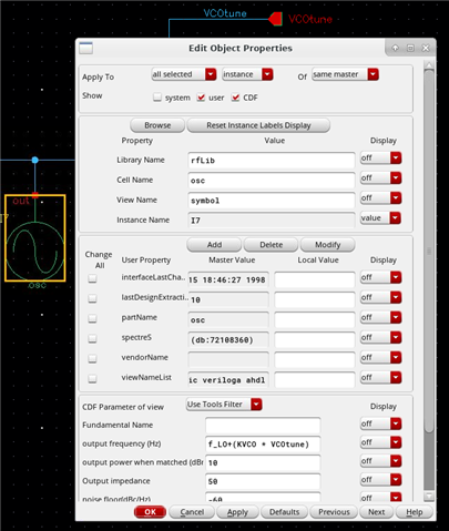

Dear Community,
I want to simulate an analog, custom PLL circuit (trans, ac, hb using ADE XL). For this I need to implement a behavioral VCO model, easy task in ADS so Cadence should of course offer a block for it, too. Believe it or not, I don´t manage to find anything...
In Cadence all I find is
  • vsin (analogLib) -> no tuning voltage input
  • vsource (analogLib) -> same
  • osc (rfLib) -> same
  • vco_tuning_curve (pllLib) -> no analog signal output, output voltage just represents the frequency in MHz
All are not suitable, as I need "just a simple VCO block": I want to insert a voltage signal and generate an according output signal, using parameters like free running freq (f_LO), and a linear coefficient (KVCO). Is there something I have overseen?
If not: Right now I am at the point that I might need to use the osc (rfLib) block and try to convert the actual voltage value of Vtune into a parameter which I then put into the output frequency property of the osc.
-> next problem arises:
How can I use a voltage value from the simulation and render it usable in the output frequency expression?
I appreciate any help.
Best regards,
Janis

    Dear Janis,
    > VCO model,
    In this forum, this question has arisen in the past.  One of the main recommendations I've suggested is the veriloga VCO model Ken Kundert created for a VCO in his paper at URL:
    https://kenkundert.com/docs/aacd97.pdf
    The VCO model, with potentially added jitter, is shown in Its Listing 4 on page 11.
    Let me know if I did not understood your need correctly Janis!

    Hi Shawn,
    hope you enjoyed the long weekend! I´m not in the US, im in Germany, but thanks anyways.
    So, regarding the VCO:
    Almost a success, the veriloga model from Ken is working and I can control it as I intend with a tuning voltage. However, it is a clock oscillator, the output not sine shaped.. so I´ll need to do some adaptions in the veriloga code, hope I will manage without unsteady phase jumps.
    If i´m lucky it can be done with placing a sin() expression somewhere, I´ll see. But again, I must postpone it to the next days, will keep you updated about the results!
    Janis

    ShawnLogan over 4 years ago in reply to janisw
    Dear Janis,
    I took some time to modify the veriloga model by Ken Kendurt to allow for a sinusoidal output. I then compared the time-interval error of the sinusoidal and square wave outputs of the VCO model. I've placed a short note detailing my effort and results at URL:
    ent.box.com/.../5pag7ol34nwwjuxs7rhlsny6kubj7x24
    and hope this clarifies a change you might consider to create a sinusoidal output. Let me know if you happen to be interested and have any issues with viewing the file at the link I provided Janis.
    Shawn
