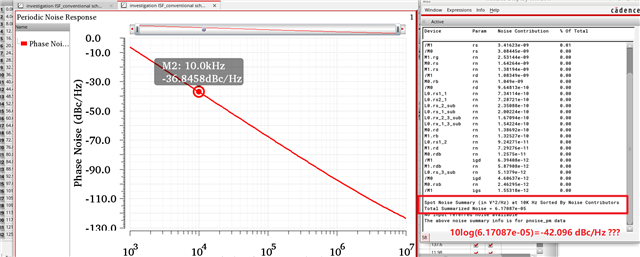

How to get phase noise from noise summary at paticular frequency?
Clara Dong
Clara Dong over 4 years ago
Hi guys,
I'd like to correlated Phase Niose curve with noise summary after pss. I decide to pick 10kHz as a test point, but I find that the logarithmic value of total summarized noise printed in noise summary is not equal to phase noise at 10kHz shown in the curve.
It seems that I should divide total summarized noise by carrier power (because the unit of phase noise is dBc/Hz), but I don't know how to get this carrier power. Could you give me some help?  Thank you :)
Have a good day~

  • ShawnLogan
    ShawnLogan over 4 years ago in reply to Clara Dong
    Dear Clara,
    You are correct. You cannot compare the results in V^2/Hz expressed in dB to dBc/Hz since the two are different quantities. You can obtain the carrier power from the pss time-domain waveform. I hope I understood your question and this provides the insight you need Clara!
    Shawn
