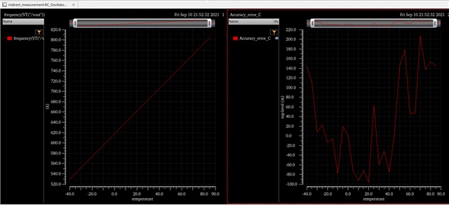

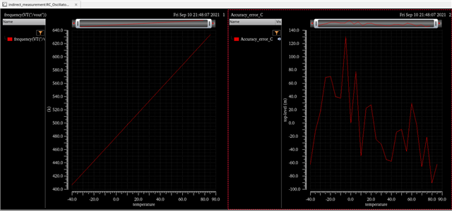

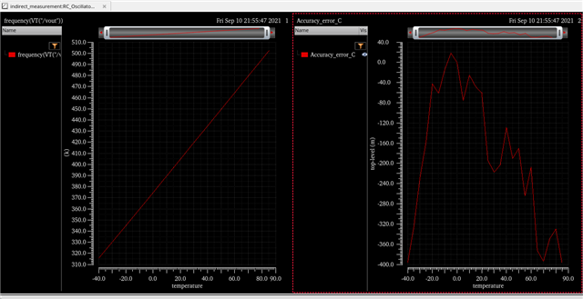

    In order to investigate this problem with you further, I have tried my temperature sensor on it to calculate the accuracy error (in °C) at three process corners with temperature variation. Note that this temperature sensor is working in the principle of temperature to frequency converter.
    The following results are performed for each corner individually. The results are following exactly the expression and I have no doubt about it

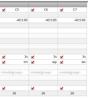

    To have all results in one simulation shot which is more convenient to compare between the process corners and also consume less time. I have selected the three corners together and I run the simulation. The simulation setup is shown below

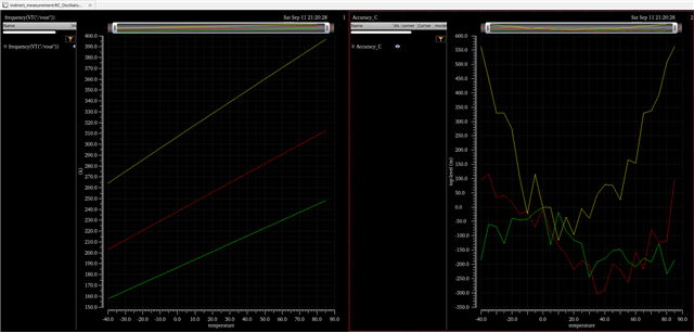

    and below is the result of the run. As you can see the output frequency on the three corners is correct. But the calculation of the sensor accuracy is not correct as it was shown before
    This is accuracy equation I am using in the output expression
    ((((average(deriv(frequency(VT("/vout"))) ?overall t) * VAR("temp")) + value(frequency(VT("/vout")) 0)) - frequency(VT("/vout"))) / average(deriv(frequency(VT("/vout"))) ?overall t))

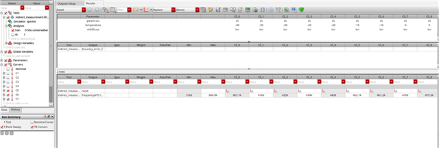

    It looks like when I select the three corners together in the last simulation setup, the Cadence is not waiting to end with the corner to evaluate the expression, he is performing the expression at every step and hence giving wrong result
    Andrew Beckett over 5 years ago in reply to Senan
    OK, EvalType=Sweeps won't work because you are doing your sweep of temperature within the corners. You didn't mention that - which was rather important. If you add sweeps within corners, it just creates sub-corners which simply means you are getting many more corners. EvalType=All won't work because it looks across all the corners, as it wouldn't magically know which subset of the corners you wanted to average over.
    This can be solved by not varying the temperature in the corners, but instead adding a global variable temperature and sweeping that instead. Then you can use EvalType=Sweeps.
