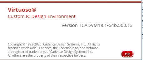

The Virtuoso version I'm using is the following:
