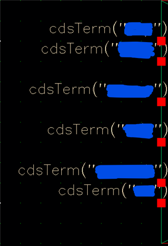

In ADEXL, when back annotating to a schematic the node voltages don't always show up. I thought going through the list of libraries in Views->Annotations->Setup and setting them correctly seemed to help, but am not sure now. Any help would be greatly appreciated. Thanks much!
    Does the symbol have cdsTerm() labels for those pins?
  • greywanderer
    greywanderer over 4 years ago in reply to Andrew Beckett
    Yes it does.
    Andrew Beckett over 4 years ago in reply to greywanderer
    Next I'd check whether all the nodes are being saved - are they in the dcOp database in the results browser? If not, check what whether you've turned off saving of the nodes. If they are, contact customer support because I can't think why this might be failing and I think we'd need to see it.
  • greywanderer
    Ok, this is embarrassing to admit. But the nodes were not all saved. Once they are if the nodes are not visible going through View->Annotations->Setup seems to work.
