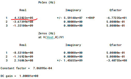

I performed a pz analysis on it, and the result showed that the transfer function from Vin to Vout in the above figure has a pair of conjugate right half-plane poles.

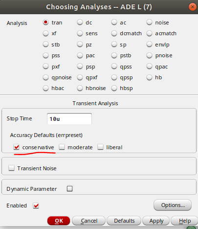

Next, I set the transient simulation as follows (accuracy is set to conservative):

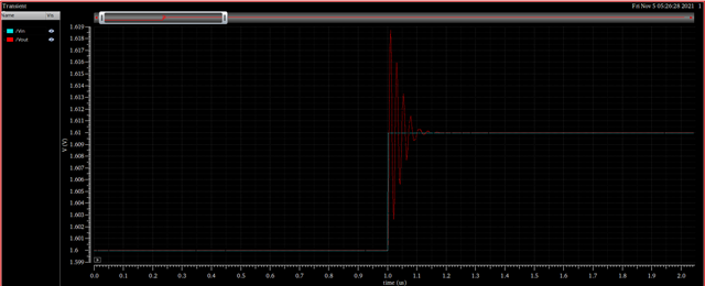

So I got the following tran simulation results:
Vout did not diverge first as I thought, but gradually converged.

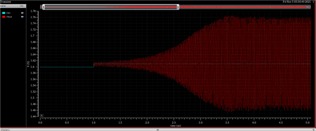

I feel something is wrong. After that, I changed the accuracy of tran simulation to moderate, and the simulation waveform this time is as follows:
This time Vout diverged first.I think this is the transient simulation result that is consistent with the theory, right?
The accuracy of conservative is higher than that of moderate. But why is the result given by conservative inconsistent with the theory?

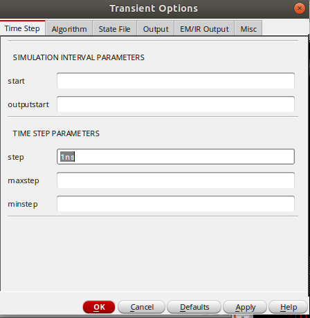

Later, I set the simulation step size to 1ns (it was not set manually before, I think spectre should decide the simulation step size by itself).

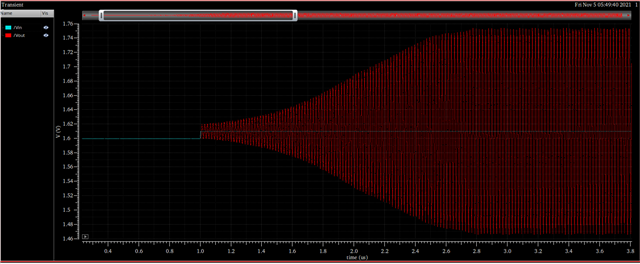

When the simulation step size becomes 1ns, the simulation results of conservative accuracy and moderate accuracy are both that Vout first diverges and then tends to stabilize the sine wave (I think this is the phenomenon that RHP should produce).

    This is probably due to the fact that conservative uses method=gear2only  whereas moderate uses method=traponly. The gear2 method is usually the best bang for the buck in terms of accuracy (you get better accuracy more cheaply than tightening reltol further in most cases) but it does introduce a small amount of numerical damping and that's probably what is causing the oscillation to be damped.
    Simulation oscillation in time-domain circuit simulators is often difficult because it can be difficult to get the oscillation to start (because a DC might find a metastable state and there's nothing to cause the simulator to move away from that). In this case you're giving a kick start to get the oscillation to start, but the numerical damping is having an effect.
    So I'd suggest setting method=traponly (keep conservative if you need greater accuracy) to prevent the numerical damping.
