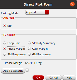

Can the stb simulation in Spectre calculate the negative phase margin?
zuiying
zuiying over 4 years ago

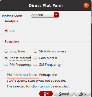

When I was simulating a two-stage op amp, I tried to use stb to simulate its stability.

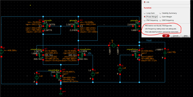

 At first I did not add a compensation capacitor (later I used ac simulation and the calculator to find that the phase margin at this time was a negative value).The stb simulation shows "PM metric not found".

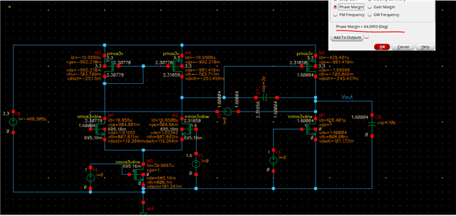

And when I added the compensation capacitor, the stb simulation showed the phase margin.
Therefore, can the stb simulation only calculate the positive phase margin, and the negative phase margin will be considered "PM metric not found"? (If this is the case, then I may prefer to use ac simulation and calculators in the future.)
Thank you very much.
    Can you show the plot of the phase and gain magnitude (edit - typo) of the loop gain? I'm assuming it's V2 you're using as the probe for the stability analysis?
    AC analysis is a pretty poor way of measuring stability (you're not really measuring loop gain and it's hard to get the loading right if you break the loop by using ac resistances/switches or even large inductors/capacitors) - so I'm not sure that's a good idea (I don't know how you set up the AC analysis).

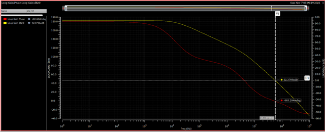

    OK.The following figure shows the loop gain and its phase when no compensation capacitor is added. (the phase margin at this time is about -0.86mdeg). But the stb simulation says "PM metric not found". I think the frequency range of 1~100MHz is large enough.

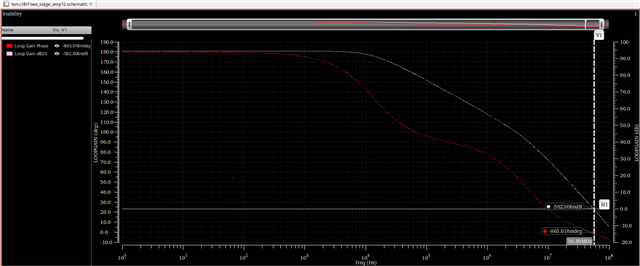

    I also tried to expand the frequency range, as shown in the figure below. But the stb simulation still says "PM metric not found".

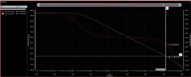

    The picture below is the loop gain and its phase when the compensation capacitor is added. This time, the stb simulation gives the phase margin.
    Andrew Beckett over 4 years ago in reply to zuiying
    It's probably a matter of definition - a negative phase at the crossing point means there is no margin at all. Maybe it could just report the phase at the point that the gain crosses unity, but it seems to be more selective than that (I don't have an example to hand to try this out)
    I suspect you could probably use the phaseMargin() calculator function on the loop gain from the stb analysis - so if you send the loop gain to the calculator and then use the phaseMargin function on it, it may do what you want (from looking at what the calculator function does, I think it should).

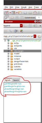

    The phaseMargin result in the Results Browser is nan.
    spectre.out is here.
    Spectre believes that the system is unstable. This should be the reason why there is no output phase margin.

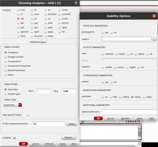

    I also did not find the "margininfo_unstable" parameter.

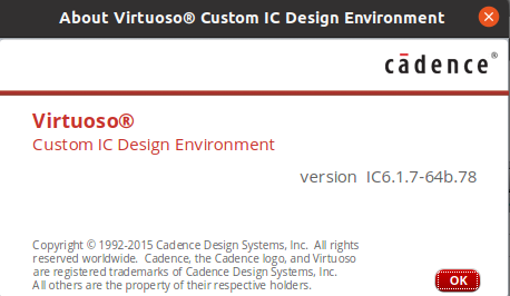

    I am using the spectre emulator in virtuoso (version information is as follows).
    I'm just more used to negative phase margins. But stb may think that a negative phase margin means no phase margin.
    Is there any way for my version of the software to make stb output negative phase margin? (This may cure my obsessive-compulsive disorder. Hahaha)
     Thanks a lot.
    It's the spectre version that matters, not the IC version. Even in the latest IC version we've not added that parameter into the UI (because it's likely to be rarely used, I think).
    So, check the spectre version from the spectre log file (it will be near the top), and assuming you're using SPECTRE19.1 ISR9 or later, you can then type margininfo_unstable=yes into the additionalParams field on the stability analysis options form.
    If you're using an older Spectre version and can't update it for some reason, then you'd have to send the loopgain to the calculator and then use the phaseMargin function on that. That should work too.
