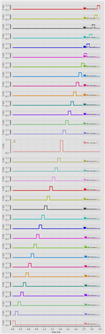

I have a problem when I try to save the image of my circuit that have many outputs,
the problem is that the saved image capture only the visible signals from the simulation result viva window, as an example I have about 20 signals but when I save the image I can only see like 8 signals.
Hence I am saving a batch of signals every time and merging them using third party software,
I believe there is a way by Cadence where it could be done more perfectly in one shot and save the image quality and effort, and for this, I need your help

    I just want to mention that I found the answer by the help from other forum as follow:
    1. change minimum height of analog strip to 1: RMB on graph → Graph Properties→Strips
    2. Save image with enough height.
    As an example the result shown below
    Thank you
