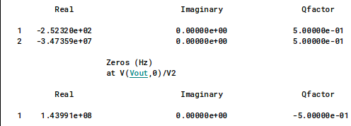

The pz simulation results are as follows.
There are two poles here, which correspond to the pole positions after Miller compensation.
But I think there should be a mirror pole and a pole contributed by the tail current source (M5).But pz simulation does not give these two poles.

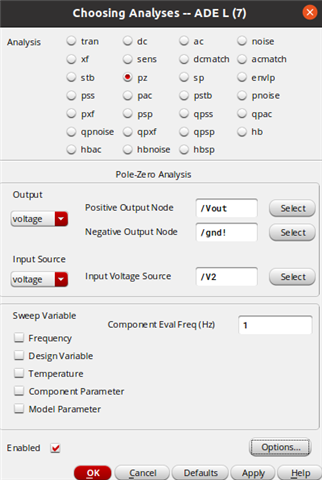

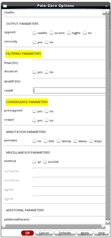

    Unless I overlooked it in your post, I am not sure what you have specified in the pole-zero analysis GUI options panel shown in Figure 1. There are options to filter out poles and zeroes above a certain frequency as well as to filter out poles and zeroes that are close to one-another (i.e., pole-zero cancellation). The latter are also dependent on the accuracy settings absdiff and reldiff.
    Filtering can also be performed by the Direct Plot form following the pole-zero analysis, and I am not sure if you specified a filter in that GUI.

    Clearly the poles and zeroes will vary in location with your value of C2 and hence if you are doing any filtering of the poles and zeroes, you could potentially filter them out if you have multiple values for C2 - especially if C2 is varying by a factor of 1000.
    Once again, I am not sure of the details of your pole-zero analysis and hence this may not be applicable. You might, however, consult the Spectre manaul to review the default values for its analysis as they may not be appropriate for your very large values of C2 and R0 - clearly these values are not realizable and may present challenges to spectre's default accuracy settings.
