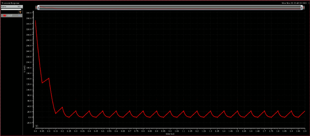

    If I run this:
    spectremdl -design invs.scs -batch mvarpwr.mdl
    then I get the max_pwr reported as 0 in each simulation and in the summary. Uncommenting the line in the zero section doesn't help - it then finds a different solution but given that the goal is not working, it's not right. I found a workaround by adding a "run trans" (see the comment about a workaround above). Then it works properly and you see the max_pwr appearing in each individual run and in in the resulting optimisation.
    I filed a change request (CCR) 2578561 for this. I suggest that you contact customer support and ask for a duplicate to be filed so that it can be associated with a real customer rather than just appearing as an internal request.
    Let me know if the workaround works for you too (assuming you're seeing the same problem). I tried with the latest SPECTRE20.1 and 21.1 versions.

    I define my measurement alias exactly as you have, but the log files tell me that the rise time is not found.
    Here is exactly how I define my measurement alisas:
    alias measurement trans {
    // definition of transient analysis with autostop turned on
    run tran( stop=1u, autostop='yes )
    // computation of risetime for signal V(out) from 10% to 90%
    export real rise=risetime(sig=V(OUT), initval=0.0, inittype='y, finalval=0.35, finaltype='y, theta1=10, theta2=90)
    //computation of falltime for signal V(out) from 90% to 10%
    export real fall=falltime(sig=V(OUT), initval=0.35, inittype='y, finalval=0.0, finaltype='y, theta1=90, theta2=10)
    export real max_pwr = max(abs(I2.NM0:pwr))
    This is what my input.measure file tells me:
    Exported variables from results directory: ././input.raw/
    date : 8:26:43 PM, Mon Nov 29, 2021
    design : // Generated for: spectre
    simulator : spectre
    version : 19.1.0.396.isr8
    Measurement Name : trans
    Analysis Type : tran
    fall = 1.30558e-07
    max_pwr = 4.22013e-08
    rise = NaN
    Swept Measurements :
    Measurement Name : trans-meas_optimize
    fall WP @ 1e-07
    WN @ 1.03162e-07 = 1.30742e-07
    max_pwr WP @ 1e-07
    WN @ 1.03162e-07 = 4.218e-08
    rise WP @ 1e-07
    WN @ 1.03162e-07 = NaN

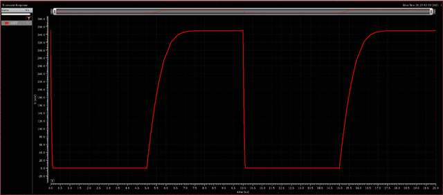

    Andrew Beckett over 5 years ago in reply to iamKarthikBK
    Can you share a plot (in ViVA) of the OUT signal?
  • iamKarthikBK
    iamKarthikBK over 5 years ago in reply to Andrew Beckett
    This is how the waveform looked earlier:
    After increasing the period in vpulse, this is how it looks:
    This is the updated testbench:
    // View name: schematic
    I2 (0 IN OUT net7) char
    V0 (IN 0) vsource dc=0 type=pulse val0=0 val1=350m period=10u delay=0 \
    rise=100p fall=100p
    C0 (OUT 0) capacitor c=20f
    V1 (net7 0) vsource dc=350m type=dc
    simulatorOptions options psfversion="1.4.0" reltol=1e-3 vabstol=1e-6 \
    iabstol=1e-12 temp=27 tnom=27 scalem=1.0 scale=1.0 gmin=1e-12 rforce=1 \
    maxnotes=5 maxwarns=5 digits=5 cols=80 pivrel=1e-3 \
    sensfile="../psf/sens.output" checklimitdest=psf
    tran tran stop=20u write="spectre.ic" writefinal="spectre.fc" \
    annotate=status maxiters=5
    saveOptions options save=all pwr=all
    Er, this seems kind of obvious. Your transient time is only 1us (the log file shows this, and the MDL earlier shows "run tran( stop=1u, autostop='yes )"). From your ViVA plot and your revised netlist, there's no rise until 5us, so clearly it won't find a rise time after the stop time!
    The rise time seems very slow for a 20f load capacitance, but presumably that's your circuit. I suggest changing the stop in the MDL to (say) 20u and then it should work.
  • iamKarthikBK
    Oops! Sorry about that. I did change it in the ADE window and regenerate the netlist, I missed the stop time in the mdl control file.
    This works :)
    Thank you so much!
