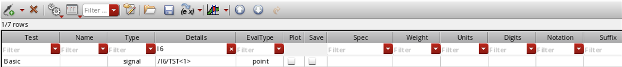

I am struggling with a very basic bug(?): ADE Explorer/Assembler just won't let me properly save current signals of a bus of an instance:
  1. I can't select "Save" for a signal, no matter how often I click. This works the first time I select the signal on the schematic but if I change the expression, the checkbox on "Save" disappears. Even if I enter the original expression, I can't select "Save" again.
  2. If I choose to select the signals on the design, my netlist is messed up and generates an error.
Example: I create the expression and select it on the schematic. Only "Plot" is checked but I can also check "Save":
Now I change "/I6/TST<1>" to "/I6/TST<2>" and both Plot and Save checks disappear. Even when I change it back to "/I6/TST<1>", I cannot check Plot or Save again, regardless how often (and hard) I click:
Ok, so then I delete the line again and select it manually again via schematic.
spectre gives me this error:
Error found by spectre during circuit read-in.
ERROR (SFE-874): "input.scs" 55244: Cannot run the simulation because syntax error `Unexpected operator ">". Expected end of file or end of line' was encountered at line 55244, column 24. Correct the syntax error and rerun the simulation.
Looking into the netlist I see:
save test\<1\> test2\<2\> test\<3\> test\<4\> \
 DATA1 DATA2 DATA3 I6:TSB<1>
This is clearly wrong! ADE netlists my netlist wrong! My expression "/I6/TST<1>" (which was selected on the schematic via ADE, not manually entered!) becomes "I6:TSB<1>". As can be seen with the test signals (which work), the < and > should be escaped.

    Which IC sub-version are you using? I just tried with IC6.1.8 ISR22 and I don't see that behaviour. That said, current signals are shown as signal (I) now and have been for some time, so I'm guessing you're using some older version.

    SteveVrk over 4 years ago in reply to Andrew Beckett
    Hi Andrew,
    Thanks for your reply and happy new year!
    I am using IC6.1.7-64b.500.18.
    I tried using creating a new schematic and maestro state but still get the same trouble. Netlist looks like:
    save I6:TSB<1>
    but it should be (escaped)
    save I6:TSB\<1\>

    Signal outputs are not expressions, and historically they couldn't be edited. Now I did try in the old version you're using (from nearly 4 years ago, and it's an unsupported version), and I found that if I tried to edit the signal name, it ended up saving it as a voltage rather than a current. I certainly did not see the name mapping issue you are describing. There was no support for saving/plotting whole buses of currents in that version. You could save buses of voltages, but not currents. Also, it wasn't clear whether a signal was a voltage or a current, and so editing the signal name could change the nature of the signal without there being any visibility.
    In a fairly recent IC6.1.8 version, IC6.1.8 ISR18 (so IC6.1.8-64b.500.18), you can now click on the pin of an iterated instance or the pin of a bus on an instance and use the "include as bundle" when adding terminal currents as well as voltages. Also since an early IC6.1.8 version there is a distinction between signal and signal(I) in the outputs. At some point (I did check in my experiments just now but didn't note exactly which version it changed in, and I'm not going to repeat my experiments since you really want to be using ISR18 or later anyway) editing the text of signal(I) signals stopped converting them into voltages.
    So to summarise, I suggest you move to IC6.1.8 ISR18 or later to do what you want - this should make your life much easier and you'll be able to do what you want.
    Note that I didn't at any point get the rather strange save statements you did with the non-escaped names. It's possible that some local customisation is breaking things - if you still see the problem after moving to the newer, supported, version which supports buses of terminal currents, then you should contact customer support so that we can do a deeper investigation.
