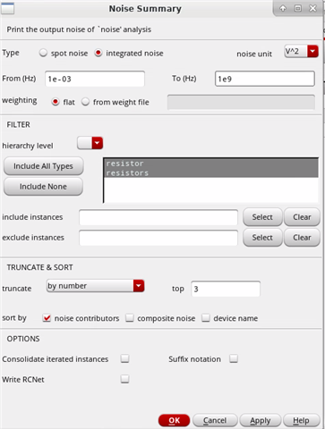

Hi All,
I am performing noise analysis on a circuit using IC618 and as of now printing the total integrated noise summary after every iteration using the Results -> Print option.
Is there a way to automatically print the noise summary after noise analysis instead of having to do this every time using the Results -> Print -> Noise summary menu ?
thanks in advance.
regards
  • ShawnLogan
    ShawnLogan over 4 years ago
    Dear sidm,
    Yes. You may add the following expression as an output expression in Assembler or Explorer where fmin_Hz and fmax_Hz are the numerical values in Hertz  that you would enter on the Print Noise Summary GUI shown in Figure 1. In the example I show in Figure 2 and Figure 3 are the Noise Summary output and the Calculator output for the expression with integration limits fmin_Hz = 1e-03 Hz and fma_Hz  = 1e9 Hz. Note the total integrated noise of both is identical.
    integ((getData("out" ?result "noise")**2) fmin_Hz fmax_Hz nil )
    I hope this is what you are looking to do sidm.
    Shawn
    Figure 1
    Figure 2
    Figure 3

    Is the context of the Calculator (assuming you are using the expression in the calculator) set to the noise database? It will be helpful if you provide more information on where you are using the expression and the context of the command. More specifically, if you add the following to the command, this will force it to use the directory in which the noise results exist:
    integ((getData("out" ?result "noise" ?resultsDir "<UNIX_path_to_psf file that contains_your_noise_simulation_result>")**2) 0.1 500 nil )
    Shawn
