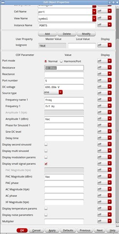

    Thank you for your answer. I am running the PSS simulation by sweeping the amplitude of the input signal (Vac) to plot THD vs Vac (dBm) for the device under test. The frequency is frf=1KHz and the input Vac is swept through the input port.
    You can find the settings for PSS and PAC analysis as well as the input port for the simulations below.

    3. Examining your input port GUI and their locations n your schematics, they all appear to be AC coupled to your devices under test. However, your port definitions include a non-zero DC bias value - which is not required and does not make sense to me.

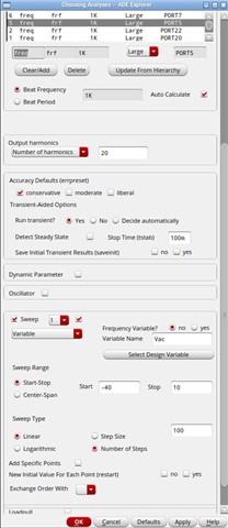

    4. I noticed in your PSS GUI, you are running a tstab portion for the simulation - which is very good in my opinion as it will provide some simulation time for the transients associated with your AC coupling capacitors.
    a. Have you verified 100 ms is sufficient in a conventional transient simulation to achieve something close to steady-state operation?
    b. Have you considered saving the transient portion of the PSS analysis to verify it also is sufficient in a conventional transient simulation to achieve something close to steady-state operation? I noticed its radio button is not checked in the GUI you provided. I would recommend you check its radio button.

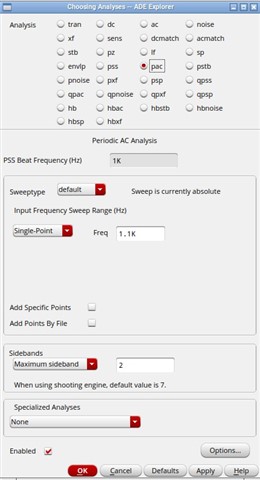

    5. In your PAC GUI, why have you specified a frequency sweep of 1.1K? I thought you wanted to compute "THD and extract IIP3" for only a 1 kHz input frequency? Is my understanding incorrect? Are you suggesting the second tone in your IIP3 analysis is 1.1 kHz - if so, doesn't that mean your beat frequency is 100 Hz not 1 kHz? I am a bit confused on the two frequencies for which you are trying to apply to compute the II3 (an IIP3 analysis relies on two or more tones and their mixing products).
    6. Similarly, on the same GUI, I noticed you have only set the maximum sideband to 2. Is this sufficient to provide an accurate estimate of your expected IIP3?

    3- I have removed those non-zero DC biases from the input ports. They was a part of another simulations and I forgot to remove them for the current simulation.

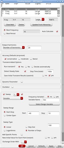

    4- Yes, 100ms is enough to reach the steady state. I could not get your point about the radio button. Where is it? I have changed the settings for PSS GUI as follow. Should I modify it again?
    5- I used 1.1KHz in the PAC GUI to introduce the second tone for IIP3 simulation by using PSS+PAC analysis. For THD simulation, I only use one tone through PSS analysis.
    6- For the IIP3 simulation at the fundamental frequency 1KHz, I need to select (2w1-w2)=900 Hz as the third harmonic frequency and 1.1 KHz as the sundamental frequency of PAC. So, the maximum sideband of 2 is enough. If I increase it, I still need to select 900 Hz and 1.1 KHz to plot IIP3.
    I see you have now checked the radio button to save the tstab portion of the PSS simulation ("Save Initial Transient Results (saveinit)"). In your prior post, it was not checked. Hence, I do not find any reason to modify the GUI any further.
