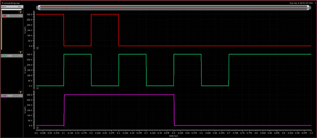

    Update:
    Seems like that is my circuit. for some particular sizes, spectre is unable to calculate the risetime because the waveform is different.
    Is there a way I can tell spectre to ignore points that result in NaN?
    Thanks

  • iamKarthikBK
    iamKarthikBK over 4 years ago in reply to ShawnLogan
    Andrew Beckett said:
    That said, it does seem a bit odd that some of those sizes are very close to one that works OK.
    Yes, but it could be due to the circuit. the output signal I am looking at, may not be rising from the initvalue to the final value.
    I want to ask is there a way I can calculate the rise time for whatever is the maximum value for logic 1?
    Example: If the signal is rising from 20 mV to 295 mV (supposed to be 0 -> 300 mV) which I can tell by looking at the waveform in ViVA, is there a way to do this in spectremdl?
    Unknown said:
    Are you able to both netlist and run a single simulation with one of the "nan" cases successfully and both view and compute the rise time?
    yes, but not for the same initial and final values, as the signal never rises in that swing (it's my circuit)
    Unknown said:
    What is driving the device for which you are computing the rise time?
    By driving, do you mean to ask about the load? It is a 20 fF capacitor. The inputs are vbit, with val1 with 0 V and 300 mV.
    Unknown said:
    What are your simulator accuracy settings and simulator?
    Not sure, in my input.mdl (for mvarsearch), I do this:
    accuracy: 1e-12
    deltax: 1e-6
    maxiter: 1000
    I don't change anything else in ADE L, I just export the netlist from there.
    Thanks
    Ahah!! This is the problem. In computing transition times - rising or falling - the conventions commonly in use are those that produce 10-90% (90% - 10%) and 20%-80% (80% - 20%) of the supply voltage - not the actual supply voltage itself - which is what I think I now understand you are doing.
    Why? The ability to resolve the actual supply voltage for any simulator is limited. For any logic gate, depending on its load, its output likely somewhat exponentially approaches the supply (rise time) or ground (fall time), but may take some time relative to the period to actual get "close enough" (a relative term) to indicate its is at the supply voltage or ground. Further, being a logic gate, as the amplitud approaches the supply or ground, its gain drops off very significantly relative to its gain near the input voltage threshold. Hence, its functionality is really not determined by how long it takes the output to come extremely close to the supply or ground.
    What i might suggest is that you choose which transition time threshold you think is most appropriate (10/90) or (20/80) and set your rise and fall time measurement thresholds to be those two values and NOT the actual supply voltage. I think this will solve your problem AND provide the type of insight you are looking to find on how device sizes are impacting your transition times.
    An yes, there is a way to cause the lack of crossing a specific threshold to fall back to a different threshold, but I honestly think the use of the supply voltage itself will just make your measurements too dependent on any circuit simulator to really provide the insight you want.

    Andrew Beckett over 4 years ago in reply to ShawnLogan
    Some comments on the last two points in this thread:
    This doesn't matter. Provided your signal traverses from below 10% of the range to above 90% of the range, it doesn't matter if it's never as low as the minimum or as high as the maximum. You're picking 10-90 in your expression.
    If you really wanted, you could use:
    export real my_rise=risetime(sig=V(OUT), initval=min(V(OUT)), inittype='y, finalval=max(V(OUT)), finaltype='y, theta1=10, theta2=90)
    However, this will prevent the auto-stop from stopping earlier, because the min/max would be across the entire waveform. You potentially could use max(trim(V(OUT),0,500n)) which would measure it within the first part of the waveform but even so, I'm not sure this is worth it.

  • iamKarthikBK
    iamKarthikBK over 4 years ago in reply to Andrew Beckett
    Hello Shawn and Andrew,
    First of all, thank you so much for your time and patience.
    To the others, TL;DR -
    This resolves the problem I was facing because I know exactly how the output waveform is supposed to look for my inputs, and trim is the best way to ensure that the optimizer doesn't stop at suboptimal solutions (given that the circuit is behaving the way you want, and you wanted to find the rise for that particular edge, for whatever voltage rises).

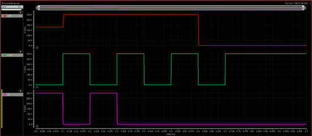

    I tried this, but as Andrew mentioned, the signal never rises from/to the values hard-coded into the MDL script (initval and finalval)
    In my particular case, the waveform looks something like this, for the NaN cases:
    I was confused as to why this is happening too, this circuit is a D Flip Flop. I tried 2 structures, 1 from gsclib045 (DFFX1), and another from here, and they both gave me the same kind of waveform. I have also sized both these circuits in another method earlier, characterized them using Liberate, and performed synthesis with no timing violations. Hence, I would assume that there is no mistake in either circuit.
    Checking the waveforms in the problematic condition would help understand this, and maybe your initval/finalval need to be adjusted
    Yes, this was done by using max(trim(V(OUT)),0,350n) and max(trim(V(OUT)),350n,1u) for rise and fall respectively (as the input combination and output combination is known)
