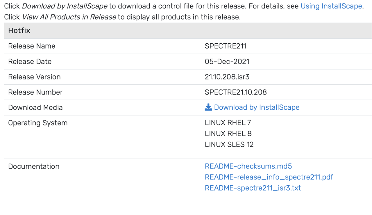

    Andrew Beckett over 4 years ago in reply to Firdos +1
    Are you running on RedHat 6 (or similar?) . What does “lsb_release -a” return in the UNIX terminal? spectre 21.1 dropped support for the older OS, so that may be your issue. Andrew
    That would explain it then. As you can see from downloads.cadence.com it's only supported on RHEL7 and above - see this screen grab:

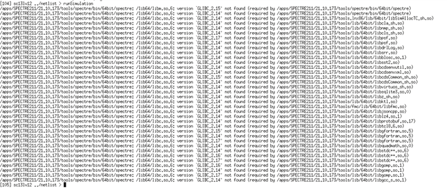

    Alternatively, run the simulator standalone using the runSimulation file in the netlist\n directory to know the exact cause of the error
    This bit is the clue as to how to debug this. In ADE Explorer, you can start a terminal (either right mouse->Open Terminal over the outputs, or do Window->Toolbars->Results and press the terminal icon). Then "cd netlist" and in that directory there should be a script, runSimulation. Try running ./runSimulation and see what happens.

    Firdos over 4 years ago in reply to Andrew Beckett
    I have tried to do that. It says "GLIBC_2.15 not found. I have attached he image of the response that I get.
  • Firdos
    Firdos over 4 years ago in reply to Firdos
    It seems that spectre211/21.10.173 does not support. I have tried by unloading this spectre and loading some older spectre. Now it is running.
