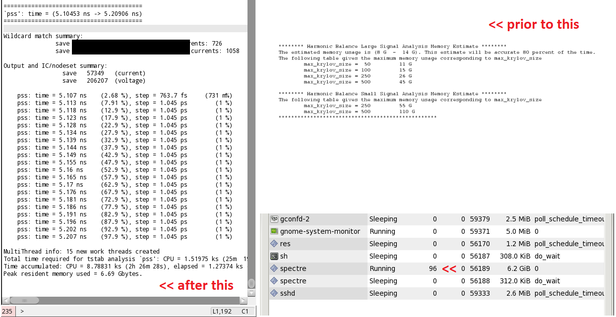

For a fairly large design, my .pss/.hb simulation spends hours calculating something after the initial transient and before printing the memory estimate. It is not using the multiple processors it is allocated at this certain stage, yet it is taking the multi-core licenses. Does anyone know what spectre is doing, and is there a chance to speed it up?

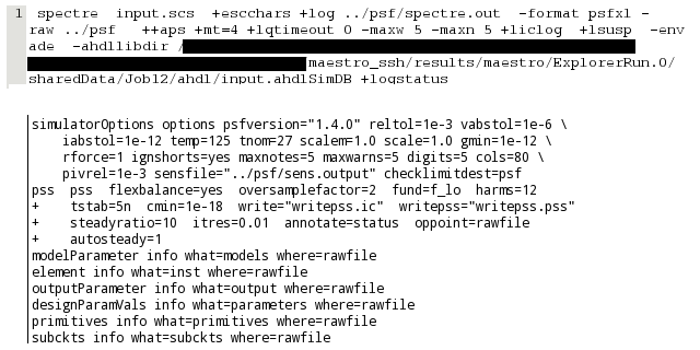

    b. In other words, might you post the specific pss and potential following-up simulation sections of the input.scs file from the netlist directory?
    c. To understand which type of spectre simulation you have selected, might you also post the specific spectre run line contained in the "runSImulation" file also in the netlist directory?
    i. I am wondering specifically if you are using plain spectre, spectre +aps, spectre ++aps, or spectre X. As detailed in the Cadence Blog at URL:

    Thanks for the quick response. I am concerned with the specific stage marked in the screenshot, whereas tstab and hb iterations are pretty quick. For a 4-hour wall time simulation, 2 hours is spent at that stage.

    1. This is a driven circuit at 28.7G/3 Hz. The slow stage is after tstab and before hb iterations, so my wild guess is, is it calculating fft from time-domain waveform?
    2. There is no extracted view. But it does have a long chain of RF blocks.

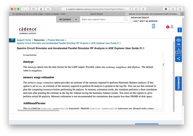

    1.  This is rather surprising to me. If the memory estimator is not enabled in the Harmonic Balance "Misc" options tab, there is not supposed to be a memory estimate performed nor reported in the output log.  Figure 1 outlines the discussion of the feature's enable/disable feature from a recent version of the SpectrRF manual. Hence, if you disabled it and the memory estimate is still both performed and reported, this is worth discussing further.

    I was going to suggest that the memory estimate is nothing to do with turning on the memory estimation - it does that anyway. I've no idea from what you've posted how large the circuit is, but it would need to be doing FFT at that phase to compute the start point for the frequency domain analysis. I'm not sure I'd expect it to be that slow though.
    Not sure why you have steadyratio=10 or itres=0.01 set - I'd remove those (it would be pretty unusual to set those). Also, do you really need cmin set? I'd remove that too.
    Actually, it does include some level of memory estimation whether you ask for it or not in current versions. There's nothing to be concerned about here.
    Unknown said:
    The Fourier analysis to compute the frequency components is performed after the pss simulation as it uses the pss time domain solution to compute the response. Hence, I think the Harmonic Balance convergence must be achieved before the resulting pss Fourier analysis is performed.
    Not really. If you use the transient assist (or tstab) with harmonic balance analyses (including PSS in harmonic balance mode) then the final period of the transient is analysed using a Fourier analysis to help with an initial starting point for the harmonic balance analysis. The hb analysis solves the frequency domain equations for the circuit, and even during the iterations of that it will do repeated inverse Fourier, time-domain solve, and then normal Fourier to convert back into the frequency domain. At the end, the time-domain solution (if output) is generated using an inverse Fourier analysis from the frequency domain result.

    I'm not sure small time steps have anything to do with this. The pause here is in the pre-conditioning stage prior to the harmonic balance algorithm itself starting - and as I mentioned in my previous reply, it's very hard to know what's going on without more detail - hence my suggestion to contact customer support (as well as remove some of the options which I think have no place being there).
