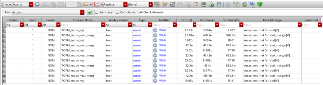

Hi all.
I am using IC6.1.8-64b.500.10.
I have table with asserts which is generated using asserts .scs file:
Navigating to to schematic for a device that is causing break of assert works by clicking on a device.
As far as I could understand for checks there is option to view critical part in transient analysis graph.
Is there a way, or is it expected in new release, to plot graph for broken asserts regions?
Best regards,
Dragan
    Dragan,
    Some asserts can also show the bookmarked region - it rather depends on whether a signal can be identified that is available to be plotted - it's not always, because some asserts may be related to data (e.g. operating point parameters) that are not present in the output data, so there's nothing available to plot.

    Thank you.
    I was about to withdraw the question.
    In given example there is no, for instance, net to plot waveform for.
    Best regards,
    Dragan
