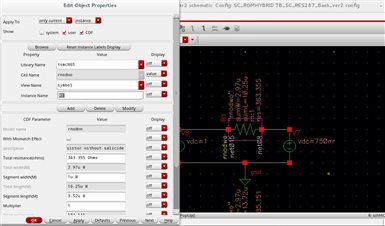

Hi All,
When I update the W, L parameter for any resistor in my schematic it still displays the default or the previous value which is present. This problem is resolved only when I restart cadence and instantiate a new resistor . Can anyone please
help me with a workaround for this?
    How are you changing the parameter? If it's through SKILL, then it may just be that the callback is not being invoked. If you're editing it through the edit properties form, then it's either the PDK is not installed properly or there's a bug in the PDK (for which you should contact TSMC - it would be their code that is failing).
