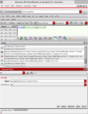

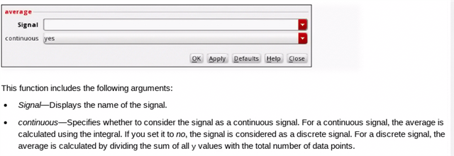

    Andrew Beckett over 4 years ago in reply to abdurrahman0234
    I combined your duplicate posts.
    You'd need to use the sample() function in the calculator to sample at the points where it is flat, and then use the average function with the fairly new continuous option set to "no". This was added in IC6.1.8/ICADVM20.1 ISR19 and means that the average is computed by summing the y values at all points (this is why you want to sample it first) and dividing by the number of points. The default (continuous=yes, which was the old behaviour) works by integrating the area under the curve (including the transitions) and dividing by the x-range - so that's going to be slightly different.
    Your last two questions are slightly garbled so I'm not entirely sure what you mean. If you have a waveform such as the red-pink signal you showed in a graph before, that is suitable for feeding to the average function, although as I said you'd probably want to sample it first to ensure you only have one point per period, and then use average with ?continuous "no" - which can be chosen from the calculator (assuming you're using a recent enough version):

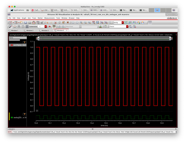

  • ShawnLogan
    ShawnLogan over 4 years ago in reply to abdurrahman0234
    Dear abdurrahman0234,
    As did Andrew, I tried an example of the operations you were intending and found the following:
    1. I sampled an analog clock waveform asynchronously between 15 ns and 16 ns (i.e. sample points were at a frequency that is not the same frequency as the frequency of the clock waveform) and applied the analog2digital() calculator function using the following expression:
    analog2Digital(sample(clip(v("/clk_p" ?result "tran") 15n 16n) 15n 16n "linear" 1e-12 ) "hilo" ?vHigh 0.60 ?vLow 0.20 ?timeX 1e-12)
    2. I also sampled the same analog clock waveform synchronously using two samples per period of the analog clock waveform period as detailed in the Calculator expression:
    analog2Digital(sample(clip(v("/clk_p" ?result "tran") 15n 16n) 15n 16n "linear" 1e-12 ) "hilo" ?vHigh 0.60 ?vLow 0.20 ?timeX 0.50/frequency(clip(v("/clk_p" ?result "tran") 15n 16n) ))

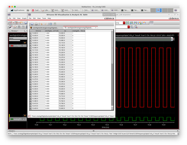

    3. I plotted the analog clock waveform between 15 ns and 16 ns as well as the two versions of the outputs of the analog2Digital() function expressions in Figure 1. Note that the expression shown in [1] above has a number of "X" values since the sampling times occasionally occur where the analog waveform is between the 600 mV and 200 mV values defined as logic high and low values respectively. However, the samples of the synchronously sampled waveform after the analog2Digital() expression in [2] has no "X' values as all samples are either above 600 mV or below 200 mV.
    The values for the three waveforms were exported to a table in order that you may see the unknowns in the asynchronously sampled waveform in Figure 2.
    4. In its current state, it appears the average() function with the ?continuous argument set to nil (i.e., "no" in the function panel) does not provide its expected value when its waveform argument is digital. The average() function without the ?continuous argument set to nil does accept a digital waveform. However, in your case, you do not want the average value as defined by a continuous integral overaged over the waveform's x-axis values. Hence, I did the following:
    i. I converted the digital waveform to an analog waveform with analog logic high and low set to 1.0 V and 0.0 V respectively and the "X" value set to the average value of the logic high and logic low. This is the full expression:
    awvDigital2Analog(analog2Digital(sample(clip(v("/clk_p" ?result "tran") 15n 16n) 15n 16n "linear" 0.50/frequency(clip(v("/clk_p" ?result "tran") 15n 16n) )) "hilo" ?vHigh 0.60 ?vLow 0.20 ?timeX 0.50/frequency(clip(v("/clk_p" ?result "tran") 15n 16n) )) 1.0 0.0 "(vhi + vlo)/2.0")
    I plotted the waveform and its digital version:
    and show the result in Figure 4.
    The values of the two waveforms are shown in the Table in Figure 5.
    ii. If I now take the average() function with the ?continuous argument set to nil:
    average(awvDigital2Analog(analog2Digital(sample(clip(v("/clk_p" ?result "tran") 15n 16n) 15n 16n "linear" 0.50/frequency(clip(v("/clk_p" ?result "tran") 15n 16n) )) "hilo" ?vHigh 0.60 ?vLow 0.20 ?timeX 0.50/frequency(clip(v("/clk_p" ?result "tran") 15n 16n) )) 1.0 0.0 "(vhi + vlo)/2.0") ?continuous nil )
    the result is a value of 506.8E-3. If I take the average() function without the ?continuous argument:
    average(awvDigital2Analog(analog2Digital(sample(clip(v("/clk_p" ?result "tran") 15n 16n) 15n 16n "linear" 0.50/frequency(clip(v("/clk_p" ?result "tran") 15n 16n) )) "hilo" ?vHigh 0.60 ?vLow 0.20 ?timeX 0.50/frequency(clip(v("/clk_p" ?result "tran") 15n 16n) )) 1.0 0.0 "(vhi + vlo)/2.0") )
    is also 500.0E-3.
    Without the awvDigital2Analog() function, the expression:
    provides a value of 2.500.
    Hence, I would suggest to obtain your desired average, which requires the ?continuous argument set to nil, you convert your waveform back to a analog waveform using the awvDigital2Analog() function. There are additional arguments to the function with a description at the Cadence On-line support site URL:
    support.cadence.com/.../techpubDocViewerPage
    I hope this helps abdurrahman0234!
    Shawn
    Figure 1
    ViVA Waveforms of Analog Waveform and its Asynchronously and Synchronously Sampled Waveforms after Analog to Digital Conversion
    Figure 2
    Tabular Values of Analog Waveform and its Asynchronously and Synchronously Sampled Waveforms after Analog to Digital Conversion
    Figure 3
    Analog Waveform (top trace) created from digital waveform (lower trace) using awvDigital2Analog() Function
    Figure 4
    Exported Values of Analog and Digital Versions of Waveforms in Figure 3
