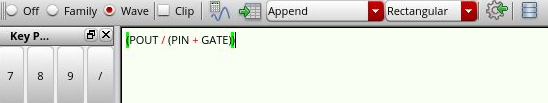

The expression for EFF is set as below:
When I try to calculate EFF from ADE, it returns the following message:
However, when I copy the exact same expression to calculator and calculate it there, it returns the correct value.

    Jin,
    There's a bit of inconsistency in your outputs - with one output being called PGATE, yet your expression being (POUT / (PIN + GATE)) (i.e. using "GATE" not "PGATE"), yet the error message is referring to PGATE, and the calculator expression is using GATE. I used the expression (POUT / (PIN + PGATE)) and it worked fine in ADE L (I see you're using the end-of-sale product ADE L) in IC6.1.8-64b.500.23 (the latest hotfix). Which sub-version are you using? (Help->About will tell you).

    Hi Andrew,
    I accidentally deleted P in front of GATE before I took the screenshot.
    You can see that the expression is correct in the error message.
    The correct expression below still experiences the same issue reported above:

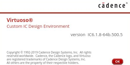

    A screenshot is attached for the sub-version.
    Jin
    Andrew Beckett over 4 years ago in reply to Jin W Kwak
    It works for me in that sub-version too. I'm a bit surprised that it would fail - it's a pretty basic capability that has worked for many years.
    Ah, it's probably this - which was fixed in the version I tried this in originally, and so when I then went back to ISR5, all my variables were consistent. It's the fact that you got the variable names wrong that's probably the problem - and then renaming them didn't help. See this article: Renaming expressions in ADE gives ERROR (ADE-1057) (it has a bit of SKILL code which should fix the expressions).
