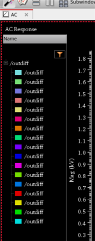

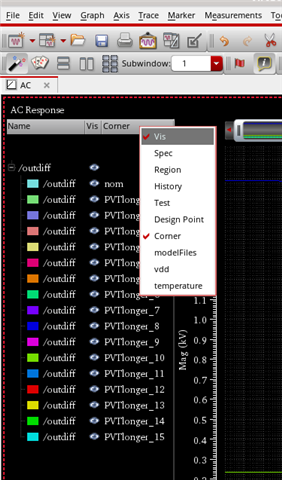

I would like to ask if I am able to remove the eye Visibility  (Vis) and the Corner name from my result and only keep the signal name from the result shown below
I have tried to save by unticking the "legend" but this will remove the signal name as well
Thank you
Regards
    Use Right Mouse button over the column headings in the legend, and then you can uncheck the Vis and Corner columns: Here's the result of having done that: Andrew
