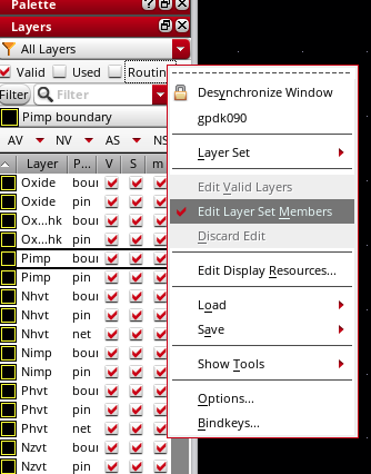

IC6 In the lsw, there are columns for layer, purpose, V, S. Sometimes m column appears (to set members). How do I turn off this column so it is no longer visible? I must be hitting some bindkey making this appear.
ascott
ascott over 4 years ago
    Right mouse button next to the "Routing" checkbox (for example) and then uncheck this highlighted entry (Edit Layer Set Members). Once you've used the right mouse button, you could hit "m" on the keyboard:
    In fact just pressing "m" on the keyboard toggles this on or off with the focus in the palette.

    thank you! I couldn't figure out how I was randomly turning this on...now I know!
