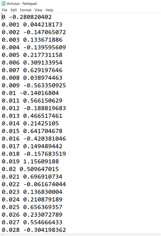

I want to use a noisy signal as an input to my circuit in cadence, and I took the following steps:-
Step 1:- I created a CSV format file of the noisy signal generated from matlab.
Step 2 :- In cadence, I went to ADE -> Setup -> Simulation files, and in the "include Paths", I included the path of that CSV file.
Step 3 :- Then I used a ipwlf source in my schematic, and in its properties I mentioned the CSV file name in "PWL file name", and also mentioned the period of that noisy signal in "Period of the PWL".
Then, while running a transient analysis, the spectre is showing error.
This is the complete error, which is showing by the spectre.
I am actually using space separated values as this:-
where am I going wrong?
    You're specifying this as a stimulus file on the Setup->Simulation Files. It is not a stimulus file (that's expected to be a spectre syntax netlist containing sources and so on). So remove that (or uncheck it) and it should then work. The error is coming because is trying to include the CSV file as if it were a netlist.

    Actually, spectre is reading that CSV file, but the reason for this error is, " Unexpected numeric value 0".
    Are the values in the CSV file correctly organized?
    This is the CSV file:-

    Please share the input netlist (input.scs). My expectation is that you've accidentally specified the PWL file name on the ipwlf source as "stimulus" rather than "stimulus.csv". Otherwise I can't see why spectre would be looking for a file called "stimulus".
  • Sachin Mishra
    Sachin Mishra over 4 years ago in reply to Andrew Beckett
    Yes Sir, you are right, I have mistakenly given the PWL file name as "stimulus" rather than "stimulus.csv".
    Now , I have corrected it, and it works perfectly.
