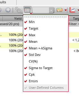

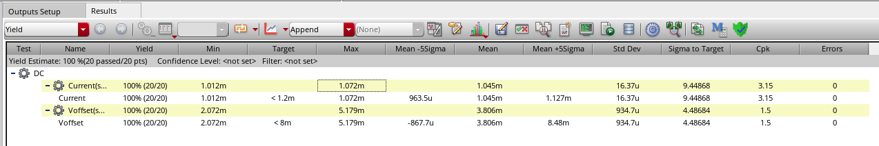

    Of course, the yield view gives you the sigma-to-target output which will tell you the number of sigma you are from the target, and if that's greater than 5 then you're OK. Similarly, the Cpk column is shown (which essentially shows the same thing, but it's 3 times smaller). I'd forgotten, but you can even get the mean +/- sigma values shown and you can set the k-sigma (this was added in IC6.1.8 ISR6). To do this, use the "configure what is shown" (which is also the adexl.gui yieldViewShowDefault cdsenv) as shown:
    (note that Mean +-kSigma and Sigma to Target aren't shown by default), and then using Right Mouse over the mean +/- 3 sigma column, you can select the sigma:
    If you click "set k Sigma" you can type in 5. Then I get:
    There's no wildcard for the output expression (wouldn't really make sense because you need multiple outputs). I think this does what you want though.

    Andrew Beckett over 4 years ago in reply to StephanWeber
    The default availability of Mean +-kSigma can be enabled using:
    envSetVal("adexl.gui" "yieldViewShowDefault" 'string "\"Min\" \"Target\" \"Max\" \"Mean\" \"Std Dev\" \"Cpk\" \"Mean +-kSigma\" \"Errors\" \"User-Defined Columns\"")
    The details are in my reply earlier in this thread. There isn't yet a cdsenv variable to set the default "k" value for k-sigma - you have to do it interactively. in IC6.1.8/ICADVM20.1. ISR27 though there will be a new cdsenv variable:
    maestro.gui yieldViewKSigma string "3"
    which will then allow this to be set. ISR27 is scheduled for mid-August 2022.
