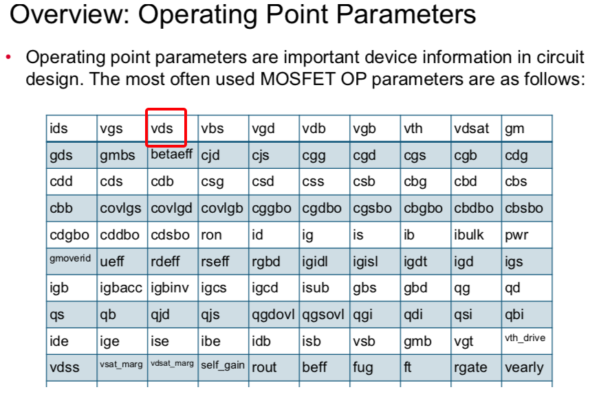

    As drdanmc also suggested, I believe you have not saved the transient signal of interest. I am unable to view the exact expression in your save statement adjacent the "eval err". However, the "vds" nomenclature is reserved for an operating point of an MOS device as shown in Figure 1 and not a signal net.
    1. To save the vds of the MOS device, you need to define the difference in the saved drain and source voltages as a signal expression in Assembler/Explorer. Ensuring you have this defined as an output save statement will allow you to plot it following your transient analysis.

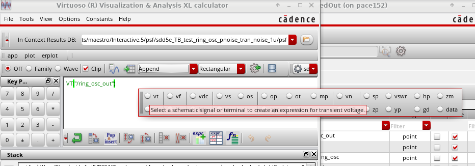

    2. The list of signal access functions, other than the more generic getData() function, can be found from the Calculator. Hovering your mouse over each will show you which access function is designed for which analysis type. In Figure 2, I show the result when my mouse hovers over the vt radio button.

    Figure 1:
    Reference: https://support.cadence.com/apex/ArticleAttachmentPortal?id=a1O0V0000090teVUAQ&pageName=ArticleContent
    Figure 2:
    Calculator Panel Indicating Signal Types to Access ("vt" information shown as mouse hovers over "vt' radio button)
