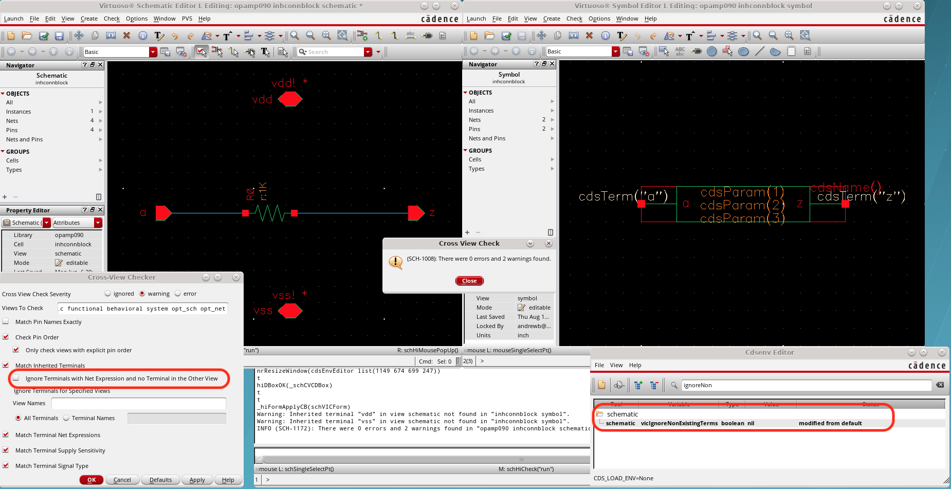

I am back doing design after a laborious period doing layout/tapeout, and am seeing a difference between how globals were treated before and how they are currently. I must be doing something different but I can' think what.
My schematic includes global pins, when I create cellview from cellview, I explicitly ask "exclude inherited connection pins".  When I save the symbol, I get a warning stating e.g. "vss! in the portOrderproperty not found in comparator symbol".
When I check edit>properties>pinorder on the symbol, the inherited pins are there, as they are on the schematic with the same check.
However, when I check back to work done earlier, I see the inherited/global pins in the schematic pinOrder but not in the symbol pinorder, thus I get no check and save warnings.
What might I be doing differently?
  • kenc184
    kenc184 over 4 years ago
    I have checked the schematic cross view and "ignore terminals with net expressions and no terminal in the other view" is set.

    It';s not the pinorder that bothers me, it's the warning created at symbol  check and save which states that the global inherited pins in the schematic are NOT in the symbol view. Well, they are not supposed to be, but they appear in the symbol's pinorder list whereas prior to this they did not. I have taken this up with support.
    By the way if I use an implicit inherited connection, the problem doesn't occur, just with explicit pins in the schematic.
    Andrew Beckett over 4 years ago in reply to kenc184
    Sorry, your earlier use of the term "global pins" threw me (I wasn't paying enough attention and only read your earlier post rather too quickly). Global pins are a bad idea and should be avoided at all costs, but it sounds as if you are talking about explicit inherited connections which have a default net name which is global. The pins (or rather terminals) themselves are not global - they are inherited connections.
    The default behaviour is to not flag pins on the schematic which have net expressions on the terminals and are missing on the corresponding symbol. If they are being flagged in a cross-view check, then it's because this option has been turned off - I've highlighted the cdsenv that controls this too:
    The portOrder will (I think) have the missing pins on the symbol too - that's because of the attempts to keep the portOrder (pin order) consistent between the views - although I wouldn't get too hung up on that. Most of the netlisters will end up having to netlist the pins on the instance and subckt definition anyway in order to connect them up - you just have the convenience of being able to miss out wiring up the pins on the instance and connect by property instead.
    Notice (and this is good practice that we recommend) that when using explicit inherited connections you give the pin names simple names (i.e. no exclamation mark in the terminal name itself) as that means you can generate layout with sensible (non-global looking) pin names but yet have the benefits of inherited connections still.
