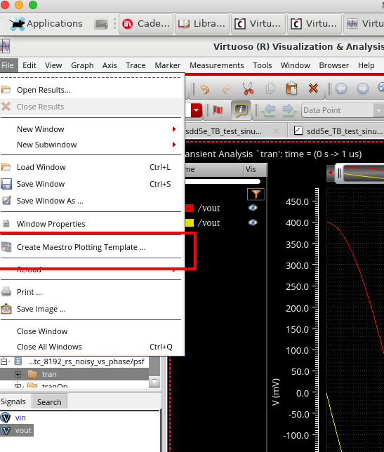

    ShawnLogan over 4 years ago
    Dear LuighiV,
    LuighiV said:
    Is there a mechanism or a SKILL script that could help that the new plotted digital signals will be in the same subwindow, instead of the default behavior that plots all in different subwindows?
    There are two methods I might suggest if you have not already...
    1. Create a Maestro waveform template from the plot you initially created where the signals are all located in a single waveform window as shown in Figure 1.
    2. Save the ViVA window as a ".grf" file and reload the window you save by choosing your new results directory as the current context and reloading the opened ".grf" file from the ViVA
    Hope these help LuighiV!
    Shawn
  • FormerMember
    FormerMember over 4 years ago in reply to ShawnLogan
    Figure 1:
    Andrew Beckett over 4 years ago in reply to FormerMember
    I was also going to suggest using plotting templates to solve this (that's better than "grf" files because it handles the changing result database location more readily, and is directly tied into ADE).
    There's also a change request that exists to handle the automatic plotting better: 2630876 (Plot all digital signals in a single subwindow). You could contact customer support and request a duplicate be filed on your behalf, but the simplest and most flexible solution is to use a plotting template.

    Andrew Beckett over 4 years ago in reply to LuighiV
    Plotting templates were added in ADE Explorer/Assembler in IC6.1.8 back in 2018. You're using a version from September 2015
