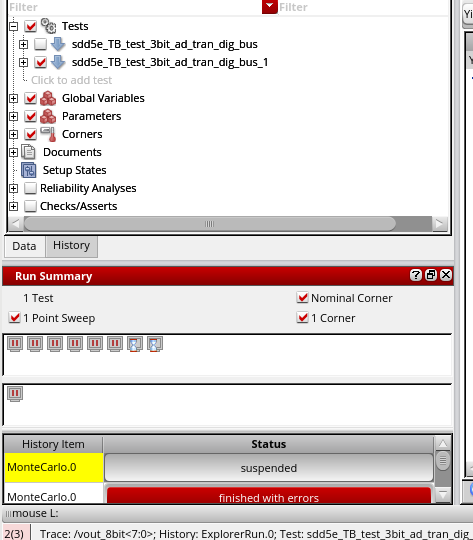

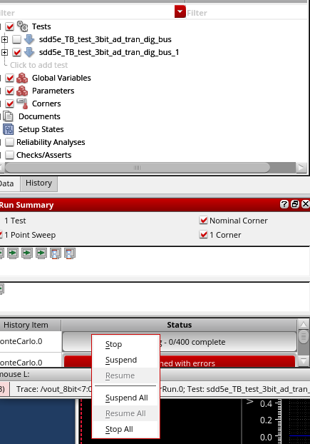

    The process for suspending a simulation set is explained as well as the process for resuming its operation. Right click on the progress bar of the job as shown in Figure 1 and you are provided the option to suspend the job. As shown in Figure 2, the job progress bar will then appear yellow and indicate it is suspended.
    Shawn
    Figure 1
    This process is explained

    I'd have thought it would be better to suspend the ICRP by using Right Mouse->Suspend over the icon in the Run Summary, and then that passes it onto Spectre. You can then Resume in the same place - no need to look up process ids. That said, ADE should really detect when the process was resumed - but maybe it was broken in the older version y you're using.
