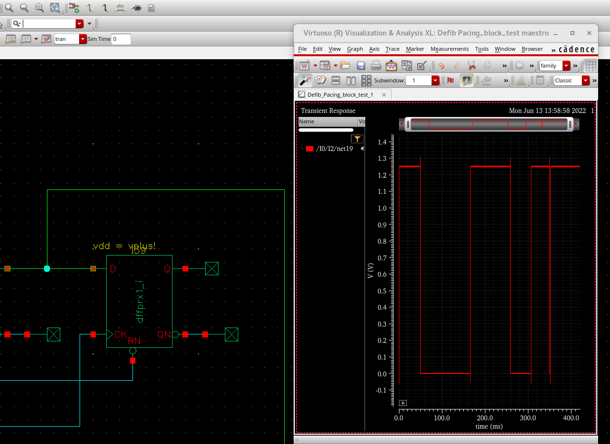

Often time a node on the schematic will not have a recognizable name attached, but clicking on a wire on the schematic in order to load it into VIva may highlight the wire in (say) dark blue.
The trace in Viva will appear in (again, say) red. Why cannot the highlighted wire colors in the schematic MATCH those in Viva?  Then looking at schematic and Viva together it is clear which trace maps to which wire.
Once one has a half dozen wire colors in the schematic and a half dozen random trace colors in Viva, it is not easy to one-to-one map them.

    As you mention, I am using  Outputs->To be Plotted->Select on schematic, then selecting the wire which then assumes a colour, Viva then assumes a colour which only coincidentally will be the same as the schematic. 9 times out of 10 it is something else.
    Here's an example, the schematic wire is green, the resultant Viva colour is red.

    Dear kenc184,
    I attempted to respond to your initial post with an example - only to realize Andrew just responded so I did not! However, one thought came to mind when I inspected the screenshot you included in your second to last post. Inpecting the net name on the ViVA plot suggests it is I0/I2/net19. On your schematic to the left of your viVA plot, the net is clearly not labeled. However, apparently you are probing a net19 two levels of hierarchy from the two - in essence net19 exists in instance I2. If this is correct, is it possible you previously selected thats ma net at an upper level of hierarchy? In otherwords, suppose the net name name signal1 at the schematic level of I0, then the net name net19 at the schematic level I2. Did you previously select net signal1 for probing at schematic level I0 and it was assigned a red color?
    Did you elect it as an output to be saved in Explorer or Assembler where it was assigned a color (prior to the simulation)?
    Shawn

    Hi Shawn,
    Something is strange. I pulled up a schematic, cleared all the "output setup" data, ran a sim then plotted two wires and the colors mismatched.
    Then I created a new schematic, ran the sim, selected outputs to plot and the colors matched.
    Curiouser and curiouser.

    Support tells me that the colours only match for previously selected signals. Any added after simulation will not necessarily match.
    I can't imagine that this would be hard to fix?

    I agree, this should be fixed. I've just reproduced some behaviour that's wrong even for signals added to the output before simulation, and it's inconsistent between the tran and DC results. I'm sure this used to work but it's broken at some point.

    Support suggested that direct plot gives matching colours. And it's true, except every one is the same colour!
    With all the complicated, amazing things the Cadence tool suite does, it is strange that something so seemingly trivial can be so poor.
