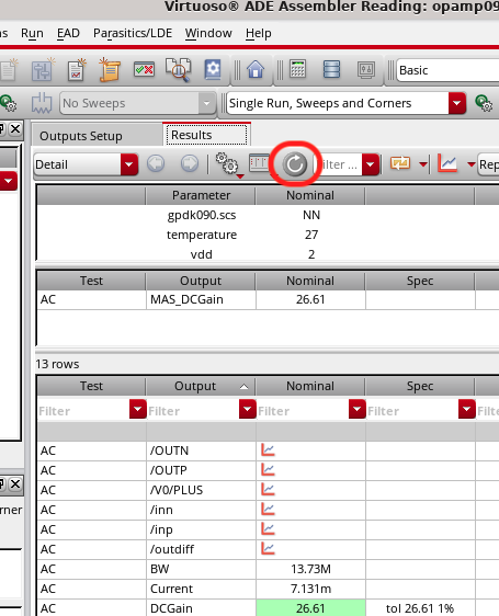

If I have inadvertently  clicked the Output heading and all results have gone into alphabetical order how do you get the original order back that matches the Outputs Setup pane?

    There's a button at the top to "Undo Sorting" (that's the tool tip): Regards, Andrew
