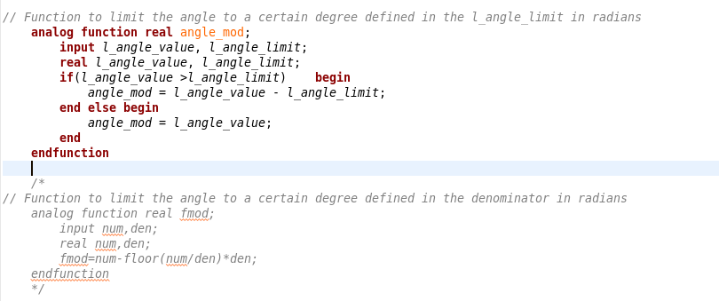

  • Ajmal Hussian
    Ajmal Hussian over 4 years ago in reply to Andrew Beckett
    I have tried both of the following ways and it works. But the problem is that during the tansition from 360 to 0 there is always an intermediate value at 180 degree which creates errors. Do you have any idea why it behaves like this?
    Andrew Beckett over 4 years ago in reply to Ajmal Hussian
    I can't see a good reason why that would happen - I don't see that with my example above. There's a risk with your implementation that the argument to the function might increase by more than one cycle in one step and so it's not truly limiting it to the modulo - I don't see any benefit in your approach compared with mine (it only seems to have a disadvantage that it might go wrong at times). In either case though, I can't see why it would have a value at 180 degrees - unless the input stepped from just below 360 to 360+180 to 720. Perhaps getting your Verilog-A model to $strobe or $debug the input to the function before it's called (and the return value too).
