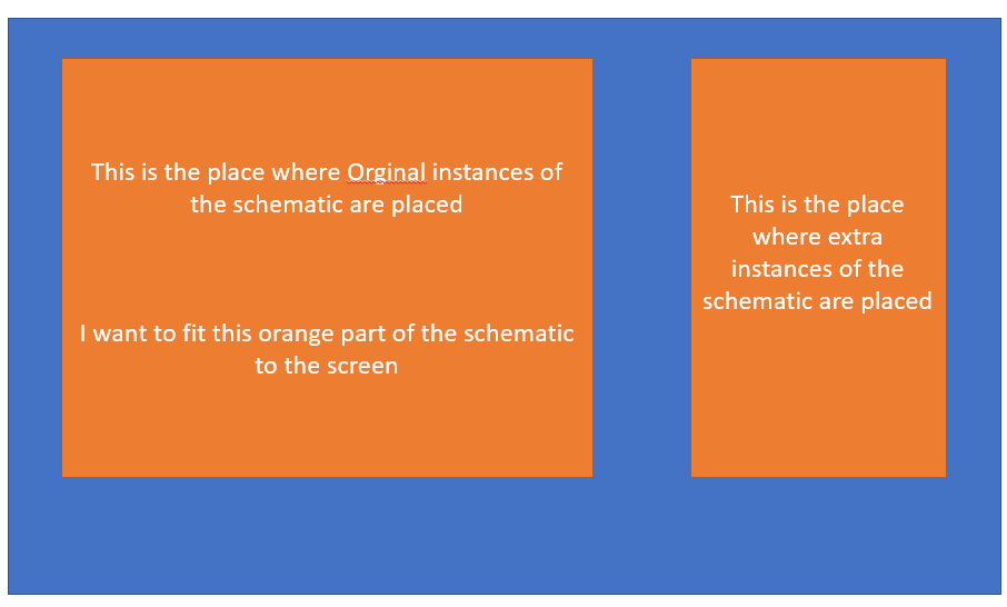

For example I am having a schematic with 10 instances and as we know when we press f it fits the whole schematic to the window, Now what if I add few more instances on the existing schematic but when i press f instead of fitting the whole schematic with extra instances i want to fit the original schematic with 10 instances.
Those extra instances are required for simulation purpose, i cannot disable them.

    Is it possible to do something with skill code like using the bBox of the original schematic and assign a key combo, so when that key combo is pressed it only fit that part of that schematic
    Andrew Beckett over 4 years ago in reply to Purbayan
    One approach would be to use Create->Note-Shape, pick "rectangle" as the shape type and draw a box in the region you want to zoom to. Then load this code that I just wrote as an example:

    and you could then put abZoomToTextLayer() on a bindkey. If you call the function, it will zoom to the overall bounding box of the text layer (the layer used for notes in the schematic editor) and if not present it will zoom to the whole cellView.
