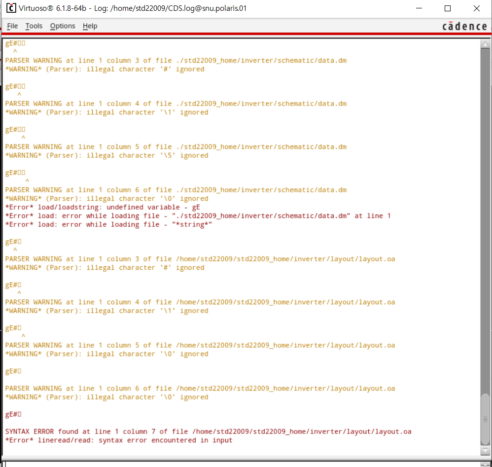

Hi everybody. I'm a korean student learning the Cadence tools.
I hope you'll help me :)
When I click the 'run lvs' button, there isn't created setting window, only error message.
There's the only error message.
The problem is that those settings windows were open last night. The problem started after I set the path incorrectly.
How can I fix it? I've been hanging on to this all day. Please help me...
    That's very odd - it looks like you're trying to load a database file as SKILL. It's really hard to anticipate what you've done wrong - I think you will have to use your University support channel - whoever…

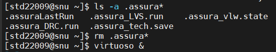

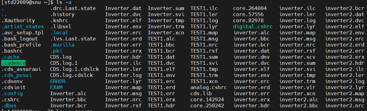

    I assume you've tried quitting Virtuoso and restarting? Also, check in your working directory in Linux and type "ls -a .assura*' - it might be wise to also delete these files (so "rm .assura*") before…
    That's very odd - it looks like you're trying to load a database file as SKILL. It's really hard to anticipate what you've done wrong - I think you will have to use your University support channel - whoever is the coordinator for the university program at your university should be able to contact customer support. We'll need to see what you've done to understand this.

    I assume you've tried quitting Virtuoso and restarting? Also, check in your working directory in Linux and type "ls -a .assura*' - it might be wise to also delete these files (so "rm .assura*") before restarting Virtuoso.

    ehdwns48 over 4 years ago in reply to Andrew Beckett
    Thank you so much for reply. I tried running what you said, but the error is the same. I'll ask the coordinator for help. have a good day.
