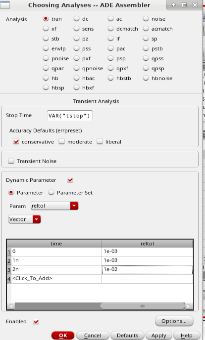

    Dear Darrell L,
    Thank you for clarifying your intent! I now understand, and note that Andrew has already provided you his suggestion(s). Basically, you would like a means to monitor the simulator time step as the simulation progresses as a means of determining if and when the simulator should save a data point. In essence, set a "dynamic" strobeperiod to a value dependent on the timestep itself.
    I am also not aware of a means to monitor the simulatot timestep, however, might I suggest that perhaps if you know the approximate times at which your waveform(s) undergo transitions that you want to capture with high simulator accuracy and the periods of time where little or no waveform changes are occurring, you might consider customizing the simuation "relotl" parameter. As you probably know, the "reltol" parameter can be varied dynamically. Higher values will allow larger time steps (and subsequently fewer data points). You can set up a table of time versus reltol value or read in a table of values from a file from the Transient analysis GUI if you check the radio box "Dynamic Parameter" (see Figure 1).
    I thought I would pass the thought by you in case you have not already considered it as a means to reduce your database size. Perhaps it is not relevant or possible, but not knowing the details of your circuit netlist and design objective, I decided to mention it.
    Shawn
    Figure 1
