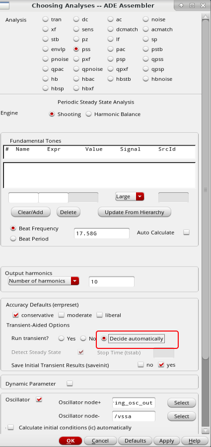

    All oscillators are unstable. In fact, if an oscillator becomes stable, it will no longer possess a periodic solution. The term "Additional time for stabilization" or "tstab" refers to an estimate of the simulation time required for its output waveform to achieve a near steady-state solution. Higher Q based resonant circuits will require longer time period to approach their steady-state solution than lower Q based resonant circuits. the Cadence periodic steady-state simulator (pss) starts to compute an estimate of the steady-state solution starting with the transient simulation result after the specified "tstab" has been achieved. A value for "tstab" does not have to be entered as the Cadence pss analysis can estimate a value for "tstab" by checking the "decide automatically" radio button shown in the pss analysis GUI shown in Figure 1.
    Shawn
    Figure 1

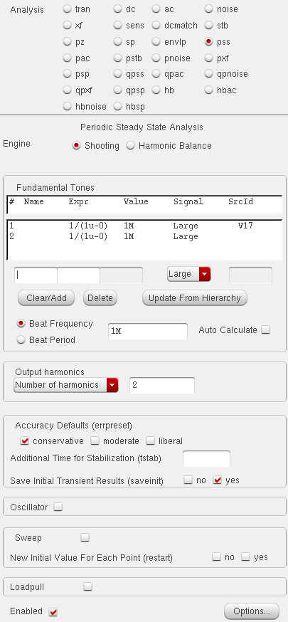

    As you advised, i tried to find "decide automatically"
    I think my virtuoso version doesn't has that content.
    In that case, how can i do similar thing that you advised ?
    My pss GUI are shown in Fig. 1
    Fig. 1
    Andrew Beckett over 4 years ago in reply to midaslab
    My guess is that you're using a very old version of Virtuoso. What does it show when you do Help->About in any of the windows? (please give the full version).
